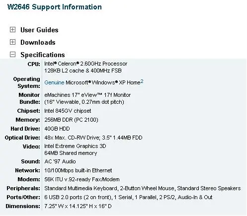

does this look like your system...?? (see attatchment)
unfortunately, it doesnt show what the maximum upgrades for things like RAM are... i dont even know what kind of MoBo it is. oh well... email tech. w/ your model number and ask for more specific specs if you need them. i'm assuming if your computer only came w/ 256mb of RAM that you are probably maxed @ 1Gb.
here's the link - http://www.emachines.com/support/product_support.html?cat=Desktops&subcat=W-Series&model=W2646

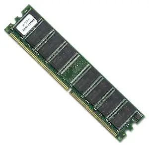

then you locate the object that looks like this...
You take that piece out, and if you have got yourself a larger one, say a 1gb or 512, you just put it back in exactly how you took it out. There's only one way to put it in, it will not snap into place any other way. Match up the notches, and press down, and your done...
BTW your system should take up to PC2700 (which is backwards compatible usually) and I think your system's max is 2gb. Your memory is located right next to the processor (There's a FAN and HEATSINK ON top of it)

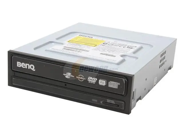

dvd drive? i'd go w/ a BenQ DW1655 (you can get the one w/ lightscribe if you want)... fast drive, dual-layer support, only $42!
LINK: http://www.newegg.com/Product/Product.asp?Item=N82E16827101008
(picture in attatchment)
and to change drives, remove one, and plug in the other the same way the original drive was plugged in (4-pin power, and IDE ribbon cable). it's easy. then install the drivers disc and you're set.
