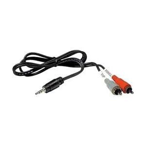

You'll need a cable like this...
I wouldn't expect too much out of the onboard soundcard, but this should work.
You'll need software. Doesn't Mac come with garageband or something? Also, check out Reaper.
Plug the RCA ends into the left and right output of the mixer. This will get you two channels- for instance... do a vocal mic into mixer channel 1 and a guitar mic into mixer hannel two. Pan one channel hard right- the other hard left. In your software, create two new tracks. Set one track to record from the left input of your soundcard and the other track to record the right channel. Now, you'll have your voice on one track and your guitar on the other...
That'll get you started for about $6. lol. If you decide you want something decent, be prepared to spend A LOT more. :D:cool:
