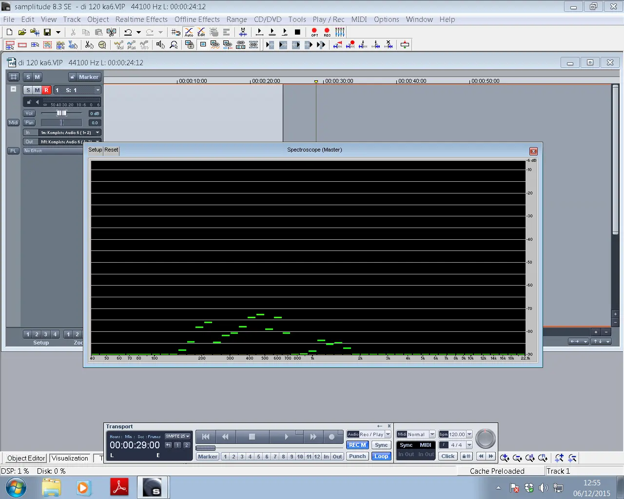

I took advantage of very quiet Sunday morning to do some tests.
Set the gain on my KA6 close to maximum and at 50mm "Rain in Spain" gave me -20dBFS average and -10dBFS on plosives.
Parked the mic in the hall behind a wall but with door open and the noise on Sam 8 meters fell to -75dBFS pk and -86rms*...You can see the result of my speech from my seat, some 2mtrs gob to SM57.
Pulling the plug from the KA6 mic input caused noise to descend to -82dBFS pk/ -94dBFS rms. I dare say if I was arsed to find/make a screened, terminated XLR plug it would be a few dB better still...As it is, I think this shows that it is random room noise that sets the noise floor for most recording purposes? Yes, an SM7b (again,,slurp) will be 6 or so dB worse but I think there is plenty of "noise floor" in hand?
The phantom power supply by the way made ABSOLUTELY no difference to the noise whether it was in circuit or not, not bad for 18quid!
*These are unweighted figures BTW and the vast majority of mnfcts quote weighted speccs. I think if you take the rms value as "wtd" you would be closer to the trade's figures.
