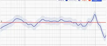

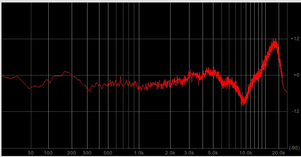

The HD 280s have some interesting frequency features, much like my DT990s.
Here is the average original frequency profile of the HD 280s. Check out that crazy 12db boost at 10khz! and then there's the massive drop off after 10k, and the big dip from 100-200hz, and the 6db boost at 80hz.
Here's the correction profile. If you have reafir, I could try sending the preset over. Or you could approximate it with any old eq.
This is great to see. I have the HD280's too and its no wonder they are somewhat hard to mix with. That bass boost is what gets me in trouble more than anything. People always comment that the bass is lacking yet I hear it perfectly in my cans...great to know!
