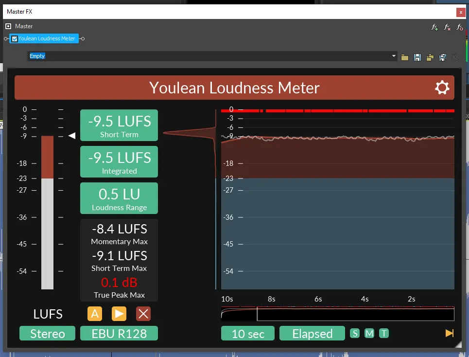

One thing I notice is that there's nearly constant true peak clipping. While it's not technically clipping in digital, the reconstructed waveform goes a bit above the highest samples, which may clip in analog depending on the converters. It seems to do so on my system, adding an additional layer of distortion to what the guitars are doing.. When I lower the digital gain by 1.1 or 1.2 dB, it seems to sound better.
The interrupted red line over the level graph indicates true peaks over 0 dBFS.
Interesting, so I use a mastering plugin (Brainworx bx_Masterdesk) that I adjust the overall level and add a little more compression as a final step on the master bus in Ableton. Would your analysis tell us if it’s clipping before it hits the master bus?..because the plugin looks like is coming out at a high, but acceptable, level. I’m just trying to figure out where to back off the volume.

I suspect it's just happening at the end of your chain. It's entirely possible that it isn't clipping as a wav file, but converting to mp3 is what's putting peaks over 0 dBTP.
The last plugin in my mastering chain is the mastering limiter. My process involves pulling the output of the limiter down by 1.2 dB and then driving the mix to the desired LUFS level (or just whatever feels right if LUFS isn't important). When converted to mp3, my mastered file peaks tend to creep up a few tenths to about -0.9 dBTP.
The disadvantage is that if you're already crushing your mix, that's another 1 dB or so you have to push the limiter to get your target level. The advantage is that it's pretty much immune to unintended clipping.
