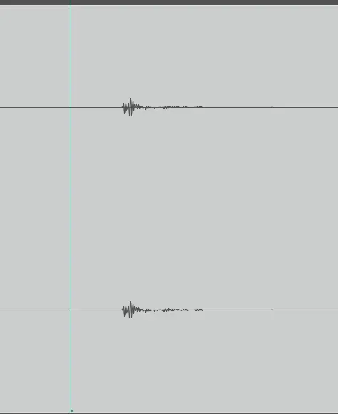

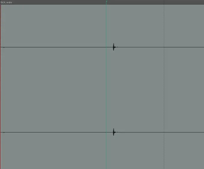

Here is the tick isolated with other studio noise taken from a recording. It is a very precise click that is totally different to any other mouth noise or whatever. Easily identifyable on the recordings. This one was in between speech so I picked it out. I will get another on my zoom in an hour.
I just left the zoom in there recording for over 15 minutes. Both monitors on and the pc fired up so a signal to the monitors. It recorded nothing.
Last week both mics recorded this tick. But there was no tick when the mics were not plugged in. This means possibly there is a tick coming from the mics when they are plugged in. Also it may not be a recorded noise but something else.
The set up is........mics on boom arm in booth ..................back to dbx 286...................then out to Audient 14...........then to pc and also out to a mixer with a desk mic to talk to booth. All of this goes to an ups ................then to a surge protector plugged into mains.
Here is the tick. You can see it is very precise.

It worked OK for me Dave - and it does, when normalised sound like a static discharge or a capacitor dumping. I think the idea to try it without the DBX might sort it out. I'd got the idea the monitor itself was 'ticking' as in the mic heard it and recorded it but you could hear the tick too? I misunderstood. Clicks are usually quite obvious when you look at them. Digital ones are one or two samples of near FS, that then vanish immediately, while analogue ones ramp up, and the decay over a few or lot of samples.
