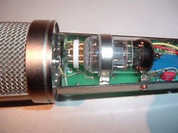

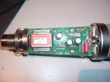

...if you look at the picture of both of my V77s, you'll notice the transformers both have "2000" dating on them (the one with the red label and platinum finish was my original mic purchased second hand in 2004...the blue labelled one which has a more shiney silver finish was actually MXL's last piece of house inventory stock which I purchased in early 2005)...all of the V77s I've seen (about a dozen or so) have the year 2000 on the transformers...I suspect that the manufacturing run of the V77 was brief, and that MXL sold off the run over a period of years to follow...I don't think the V77 was actually being manufactured for very long...I'd be curious to know what the total number of units for that model were (I might have to email Scott on that issue)...here's my pictures again:
https://homerecording.com/bbs/attachment.php?attachmentid=23136
https://homerecording.com/bbs/attachment.php?attachmentid=23137
https://homerecording.com/bbs/attachment.php?attachmentid=23139
...in the 2nd picture, you can see the newly installed tube socket in the top mic.
...in the 3rd picture you can see where the "797" was scratched out on the PCB (upper right hand corner of the PCB), leaving only the word "audio", which was MXL's attempt to mask the manufacturering source...both Studio Projects and Behringer proudly leave the 797audio markings on their mics (SP even puts the logo on the mic casing)...797audio is considered the best of the OEM manufacturers in China, having some of the better capsule QC as Phil mentioned...
