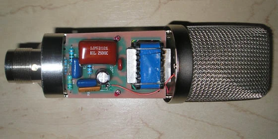

I just want to add to this that I got the Nady TCM1100 yesterday. I compared it to the photos that kidvybes posted of the insides of the MXL V77. While I can't fully tell if it is or isn't the same circuit, it definately is not layed out the same at all and has different resistors. It also does NOT have a 1.1" diaphragm as according to the packaging and brochure. It is a 1" capsule and looks to be the same as a V67 style capsule. It does not have the white retainer ring as a typical 797 capsule has. If I were to venture an unsubstantiated guess, I would bet this is more like a V76t than a V77.
Nady also claims the tube is a 6072. The tube that came in the mic had 12AX7B printed RIGHT ON THE TUBE!!! Nady also claims that a 6072 is a 12AT7. Nady apparently doesn't know their ass from a hole in the ground as a 6072 is a 12AY7! I installed a 9 pin socket so I could try different tubes. A real 6072 makes the mic sound very nice.
All that said, this is a pretty good little mic. I sounds VERY full with a tight bottom end. I really couldn't detect a sibilance issue at all. The top is pretty smooth. It also has a bit of that "3-D" quality I have found is some better mics.

I've already removed the .022uF tantalium capacitor and the 1uF 450v electrolytic capacitor and replaced them with a .022uF mylar and 1uF 250v mylar.
Does it sound better? Yes!
By a lot? No!
Any improvement is still an improvement!
Should have done a before and after, but I kind of already know what is a weakness and what isn't.

OK. Here are 2 pics of the mic after I changed the caps and added the tube socket. I added a pic of kidvybes' V77 for reference.
Sorry I didn't take any 'before' pics. Didn't think about it. The large cap in the middle replaces one electrolytic. The small red one by the grill replaced a tantalium cap. The new ones are mylars. They probably don't make that big of a difference, but it sounds smoother to my ears.

...on the microphones.com page i only can find a price of 199$ for the Nady 1100..where did you find the 119$ price?
..and why you need to install another socket to change the tube ..isn´t it possible to use a better 12AX7 tube.. i have a great 12AX7 tube from TAD which i use also in my TB-101 preamp
torkay
The company learned that its list price was a mistake. They told us the price would go to $149, but must have decided it should be higher.
You HAVE to install a tube socket to use different tubes. Nady has the wires soldered directly to the tube pins. There IS no socket.

...you could use the 12AX7 you mention, but the gain factor on a 12AX7 tube is very high...this tends to make the mic "noisey" sounding...the 6072 is a special military grade 12AY7 (lower gain than the 12AX7) that is particularly quiet due to minimal microphonics and a reinforced construction (thicker mica and additional support rods) that minimalize any "noise " factors which are critical in a microphone circuit (but just a bit less critical in a preamp)...
...if you prefer not to pay the higher price of a NOS vintage tube, the new Electro Harmonix 6072A has been getting pretty good reviews, and the price is nice!:
