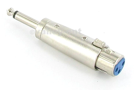

For what it's worth, all you REALLY need to record is a mic, an XLR cable, and an XLR-to-1/8" adapotor (or, like an XLR-to-1/4" cableand a 1/4"-1/8" adaptor).
I started recording in college on my laptop (pretty pimp by 1999 standards, but... :p) with one of those old computer mics that look likea guitar's whammy bar, and eventually "upgraded" to a cheapo Radio Shack SM57 knockoff with an XLR-1/4" cable and a 1/8" adaptor to run it into my soundcard. I didn't even have a mic stand, I'd just prop the mic up on whatever couple books happened to be handy, in front of my amp.
As far as audio fidelity, it was a pretty shitty setup. But, it was enough to learn on, and enough to get me hooked, which is the important bit. :D
