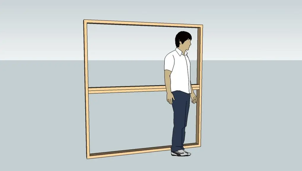

er....untill you explain a bit more, the question of insulation is moot.:)

;) Now thats more like it.:D I makes all the difference in the world when the person reading your post has a clear picture of what you are asking.
Ok, so "mic bleed" is what you are trying to prevent. Ok, I wouldn't shieth both sides of the frame. I'd leave one side open to the booth area, fill the cavities with R-19 batt insulation, and cover with fabric. The other side I would clad with drywall, plywood or OSB. And I wouldn't use plex. Use 1/4" glass, even if it costs more where you live. Actually, I'd check out thrift stores and such. Sometimes you can find old glass from fixtures etc. I've personally done this with success.
I thought having a partition would give it more of a "studio look and feel", which while it sounds like total BS, could actually prove to be the psychological push someone needs to give me a better performance!
Absolutely.:)
Essentially take that picture you posted, flip it on it's side, cover it in drywall, and put a window on the vertical middle of the right half.
Thats more like it. Exactly what I was thinking. ;)

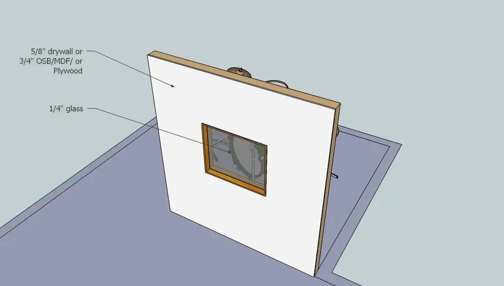

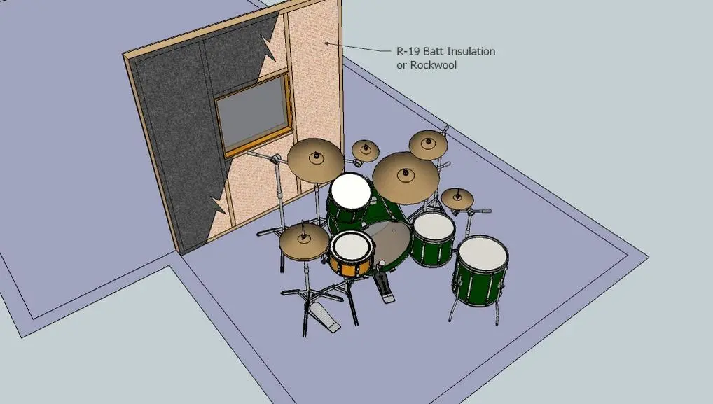

Awesome man, thanks so much!!! The pictures were also a great help, I really appreciate you taking the time to make those for me. I was gonna just do a center "beam" and put the window on the left side (from where the drums are) but maybe I'll put it in the center like your picture shows. I hadn't thought of getting a refurb window, that's a pretty good idea. I just know installing windows on the outside of a house can be a pain in the ass, but I guess if it's just for a temp wall, I don't really need to be very exact, so it will be pretty painless. I'll try to get some prices on the R-19 and see what it comes to, I might have to put it off until I get a job in September, but I figured I could slowly get the parts if each nothing doesn't cost too much individually. Thanks again!

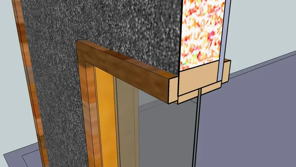

No, staple it to the frame at one corner, then stretch it to the diagonally opposite corner and staple it. Then stretch the fabric to another corner and staple it, and again to the diagonally opposite corner and staple it. Pull the fabric at the perimeter as you staple about every inch along the perimeter. Then staple it to the frame around the jamb frame. Then cut the fabric at the edge of the jamb/2x frame intersection. Then nail a wood trim over the fabric around the jamb and along any exposed edges. See the sections below. Actually, I have other suggestions for you but no time right now.
PS...get a hand stapler that uses T-50 staples and use 3/8" or 1/2" T-50's. Also, you asked about cheap insulation. R-19 is about as cheap as you find. HOWEVER...if it even took longer to save, I'd wait till you could afford OC703. Its worth it.
