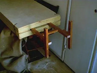

I'm a lazy man, so this is what I ended with.
The stands are made of an old bookshelves "stairs" from my attick.
Total thickness of the unit(s) is 6 inches.
I just tied them with electricians copper ground wire.
Will cover with the material in the picture.
Total cost 20€ for the canvas/ 4 units.
Cheers Matti

Resonators are calculated for one specific frecuency, mine are "unprofessional"
broadband absorbers.
Matti
