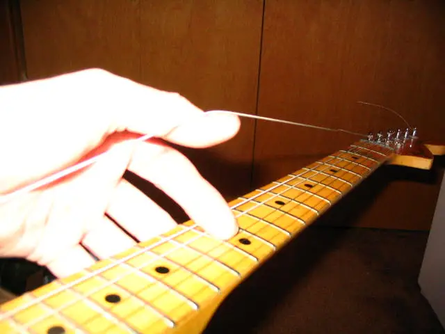

Tuning tip~
Heres a tip a blues player gave me on getting the string length close for a tight winding. Actually I do this with my left hand-my index finger on the 12th fret area, thumb extended upward, string is resting on your thumb-you thread string through the eyelet of the tuner. Turn tuner with a string winder with right hand while left hand takes up slack in the string. This gives me about 2 good windings on wound strings and 3 to 5 on unwound.
This works well for me and apologies for the over exposed picture of my hand LOL! :o
PS-I would use lemon oil on the fretboard over 3 in 1

What he said>
I also keep tension on the string while I wind it up. I think I have the string go over top of my right hand and then I hold it down with my index finger between the nut and the tuner. I also use one of those speed winder cranks so you can really get the windings nice and neat. A guy said once to look at the strings on a piano. The way they wrap them around the pegs is so they'll have good tone and stay in tune a long time. They don't tie them or cross them. Just super neat with the winds holding the string end where it goes through the peg.
Interesting-we have developed a very similar system Cephus. It seems to give the same results as far as locking the windings. :cool:
