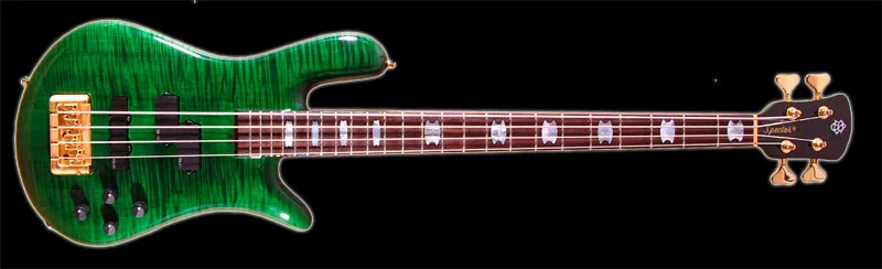

If you guys have seen the classic Spector crown inlay design you would know how easy it is to recreate. probably the same skill required to do stars or shark tooth etc. Im not talking vines or birds or anythink remotly challenging.. a refret job is a must after, and i agree with you guys that you should not try it on a expensive guitar, but if i would have spent 500.00 bucks on this inlay job alone and then later found out i could do it for less than 100.00 plus the refret and a little bit of hard work and patience i would have felt ripped off. your time is money( as you probably do it for a living) , fortunetly mine is not . i am learning a new hobby a generally having a good and productive time doing it. how did you guys get started? obviously not by sending your guitars out and letting somone else do the work,right? let tom buy a video from Stu Mac ,some esential tools and giver a go on some easy stuff. if he screws it up , he probably wont make the same mistake again, as i am sure everyone has screwed up before at some point.
If the inlays are the ones in the picture below, we could easily have done the inlay job without having to do a refret for less then the cost of the refret you ended up having to get. That is, in fact, exactly the kind of job I am talking about when I say that you don't need to pull the frets to do inlay work. To my way of thinking, you spent more doing it yourself then you would have by getting it done professionally. That is, however, what usually happens. Do-it-yourself is almost always false economy.
Thats them. i did mine in paua. the luthier that is doing my frets is forsyth guitars, you would not have heard of him. i am setting up his pc studio for him and he is doing the frets for me even trade.
