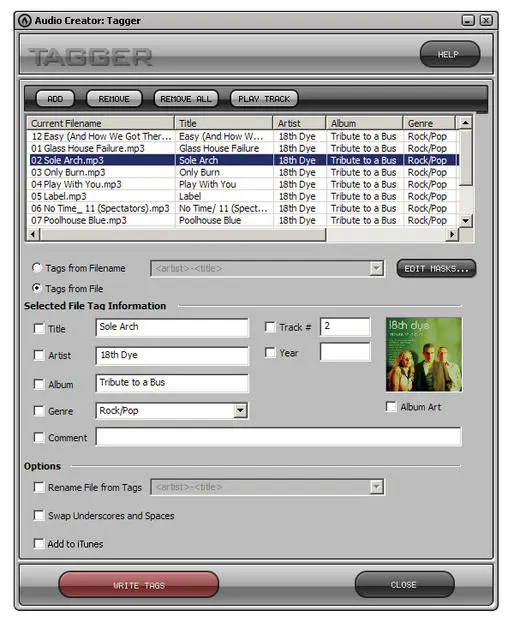

Hi - I am the one who began this thread to begin with. I appreciate all the feedback !!! I also wrote the same question on a Calkwalk , Pryro forum (I use Pyro Audio Creator) and I got this response Pasted below) from apparently a staffer at Calkwalk that seems to provide some answers:
Hi Charles,
Yes, the burning program must have CD Text writing capabilities. If you are burning a standard Audio CD then you won't be able to add name and artist info to CD tracks. All versions of Pyro cannot write CD-Text directly to an audio CD. If you have a CD player capable of playing MP3 Data CDs you can retain this information. Just burn a standard Data CD with only MP3 files.
This has been a popular feature request. We hope we can implement this capability when the next version comes around. Thanks for your patience.
Thanks !!
