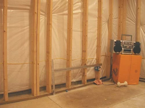

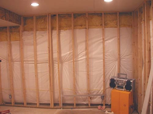

Wow. Can you guys be more specific? I know what a bass trap is, but what kind of wood? How large the slats and spaces between? space the slat over the entire surface or just the bottom? I'll post a shot of what I have. It is studs at the moment.
I'm a novice at studio building. So please speak to me like I'm a third grader. :D
Thanks,
JR
Shots of the wall
Here is the wall. I have placed a drywall ruler (48 inches long) for size reference. Two views of it.

How 'bout leaving every third space between the studs undrywalled and covering those openings with burlap, after putting a bunch of pink in the cavity? The one thing you've got going for you is a lot of space for absorption, and this may be a cheap way of exploiting it.

Yeah, the open part just needs to be acoustically open.
Jack Russell said:
And would you leave the entire space open from floor to ceiling between the stud? Or just near the floor? Doesn't the bass travel mostly on the floor?
It doesn't matter too much. Around 1/3 of the area being open into the absorber would be plenty.
