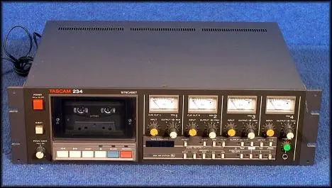

Or, another thing to try to get a listen to...maybe a Tascam 234. It is a 4 track that runs double speed, has Dbx if you like, can be had inexpensively, and will likely sound great for what I think you are wanting to do.

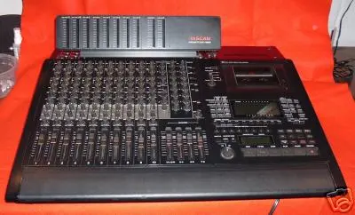

I just finished recording an album on cassette (tascam 688, so 8 tracks on 1 cassette) which kicks ass. Nobody could tell it was recorded on cassette (and cheap mics, no outboard gear, cheap hi fi speakers as monitors). Off course, I didn't play it back to professionals, but those guys won't buy the album anyway....

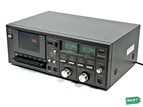

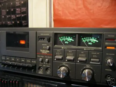

There was only one "half-track" cassette deck (that I know of), the TEAC_124/TASCAM_124AV,... which is a fine deck, but it runs at 1-7/8 ips "normal" tape speed. It's a fine sounding deck, FWIW.
PS: Not only is the TEAC_124/TASCAM_124AV a "halftrack" format, but it does "Simulsync" recording/overdubbing of tracks 1 & 2 independently. Just FYI.
Tascam 124AV.............;)

TEAC 124..............;)

Yes, the 234 is a fine 4-track cassette deck with dbx & running 2x "High Speed", (3-3/4 ips). It sounds great, has good features & is ranked as superior to many other cassette 4-track Portastudios, before or since. The 234's a great 4-tracker that's uniquely a 3U-rackmount unit, & may often be found at low-deal prices. ;)

I luv u guyz! :eek: ;)

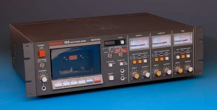

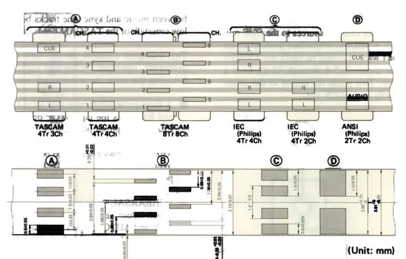

The 133 does 1x and 2x tape speeds, but it's not half track. It's a 4-track/3-channel format, with 1-track used as guard band between the stereo program and the cue track. When used with cue track, you're also limited to single-side recording in one direction only.

Tascam 133...................;)
