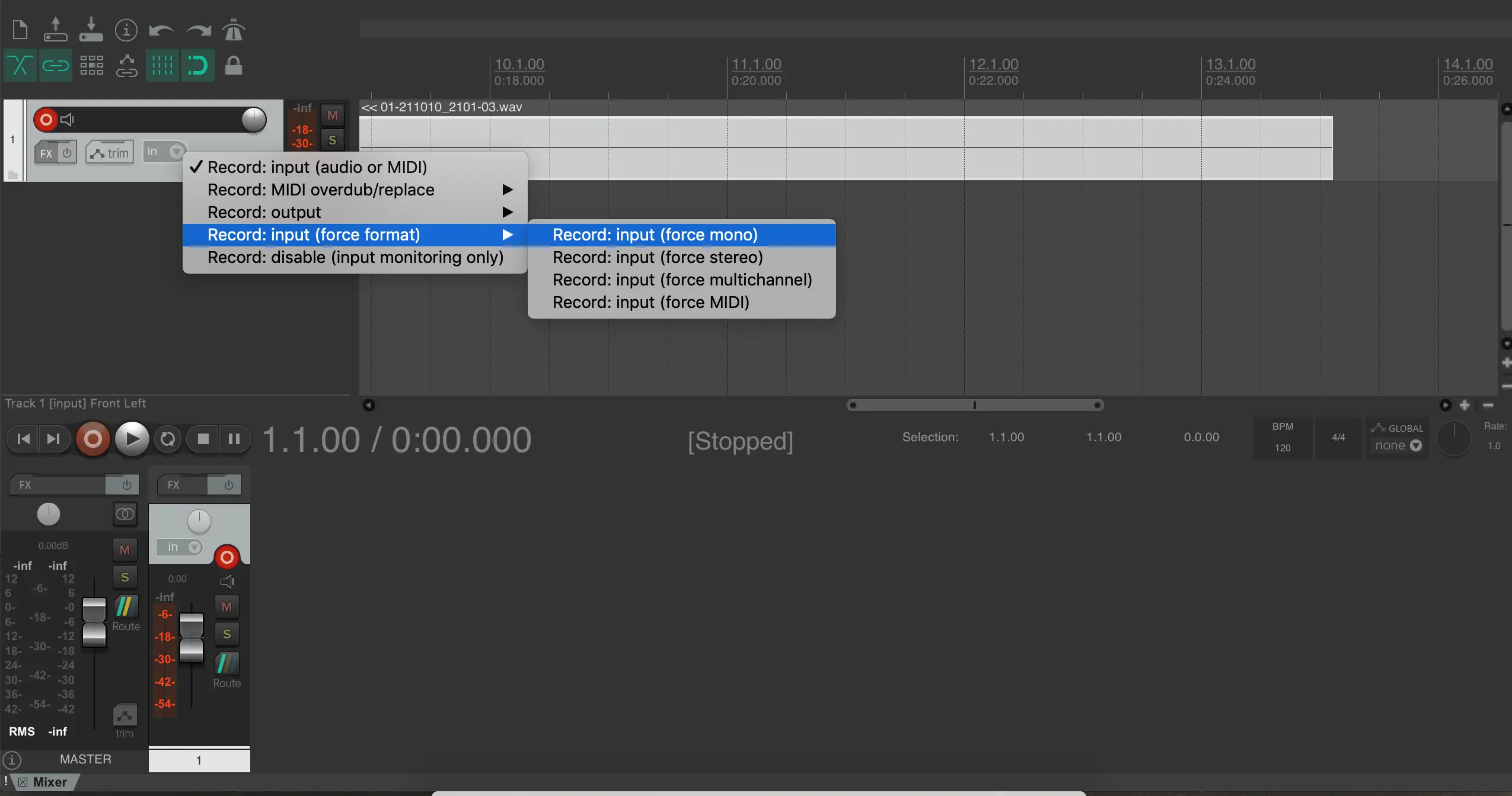

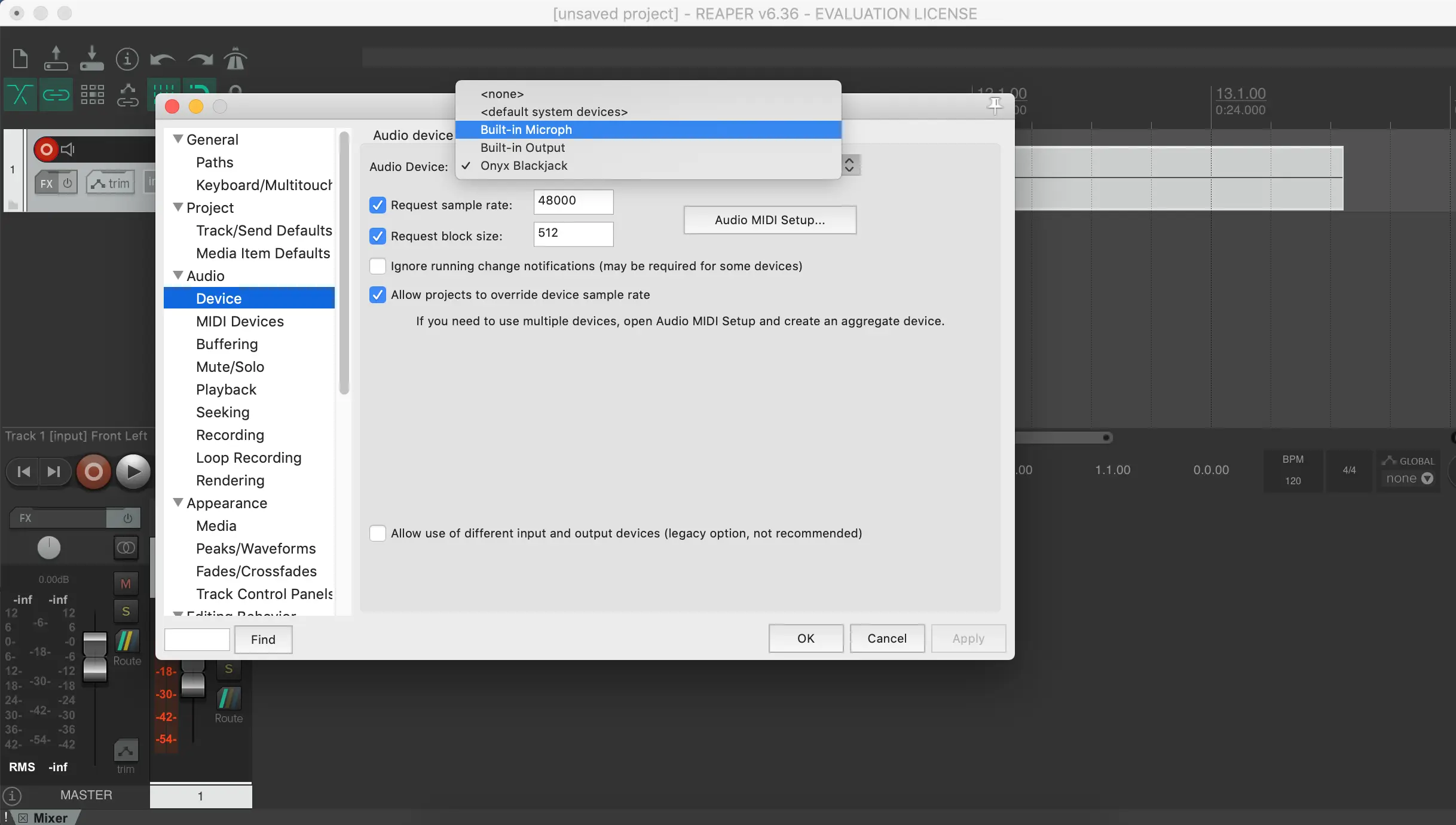

here are screenshots and yes definitely headphones jack... haha

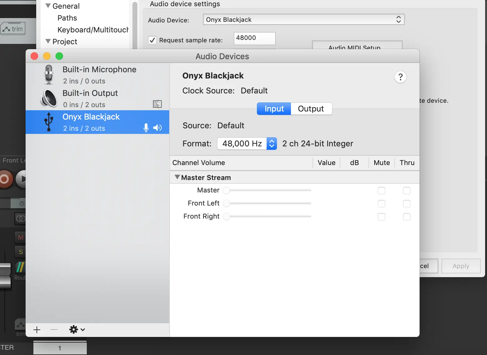

Hi,
This is interesting,
Onyx wasn't set for for input or output in "Audio/MIDI Setup", i have set it but i cannot effect the master or other volume bars when selected for output and or input. what is power cycle can you please explain this step by step.
Thanks
pic attached

Have you tried selecting this setting, this is my default:
