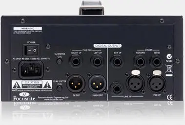

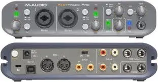

So i just bought a new Focusite ISA one and an M-Audio Fast Track Pro but i cant seem to get a signal from the preamp when i connect to the interface. If im not mistaken the mic should be connected directly into the interface right? This is where i get confused. I have a 1/4 xlr that im trying to run from the output to the interface but im thinking i need a 1/4 trs instead. I will post pics of the backs of both devices so that u guys can give me a better understanding of what needs to go where. I know this is a little elementary but bear with me. Thanks
Your interface is a mic preamp and analog to digital converters built into one unit.
You can bypass the mic preamplifiers by plugging something into the line input.
You can bypass the mic preamplifiers and the digital conversion by plugging something into the s/pdif digital input.
Either way the order is microphone-preamplifier-converter.
As it stands you'd want to use
xlr to xlr to plug the mic into the preamp (isa110),
then xrl to 1/4 to run the preamp into the interface (maudio)
The latter cable comes from xlr on isa (main O/P) to trs line input on maudio.
If you spring for the isa digital add on card you can bypass the maudio mic pre and converters.
