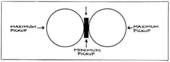

I can see where the polar pattern wouldn't be symmetrical as in their diagram, but it does indicate maximum pickup Front/Back - most likely with front and rear pads removed. That's what got me curious about this at the start.

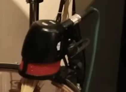

What's this mic?
I spotted it in a Jacob Collier video -- it's not actually being used while in the shot, but appears to be over a drum that has a brush on it?

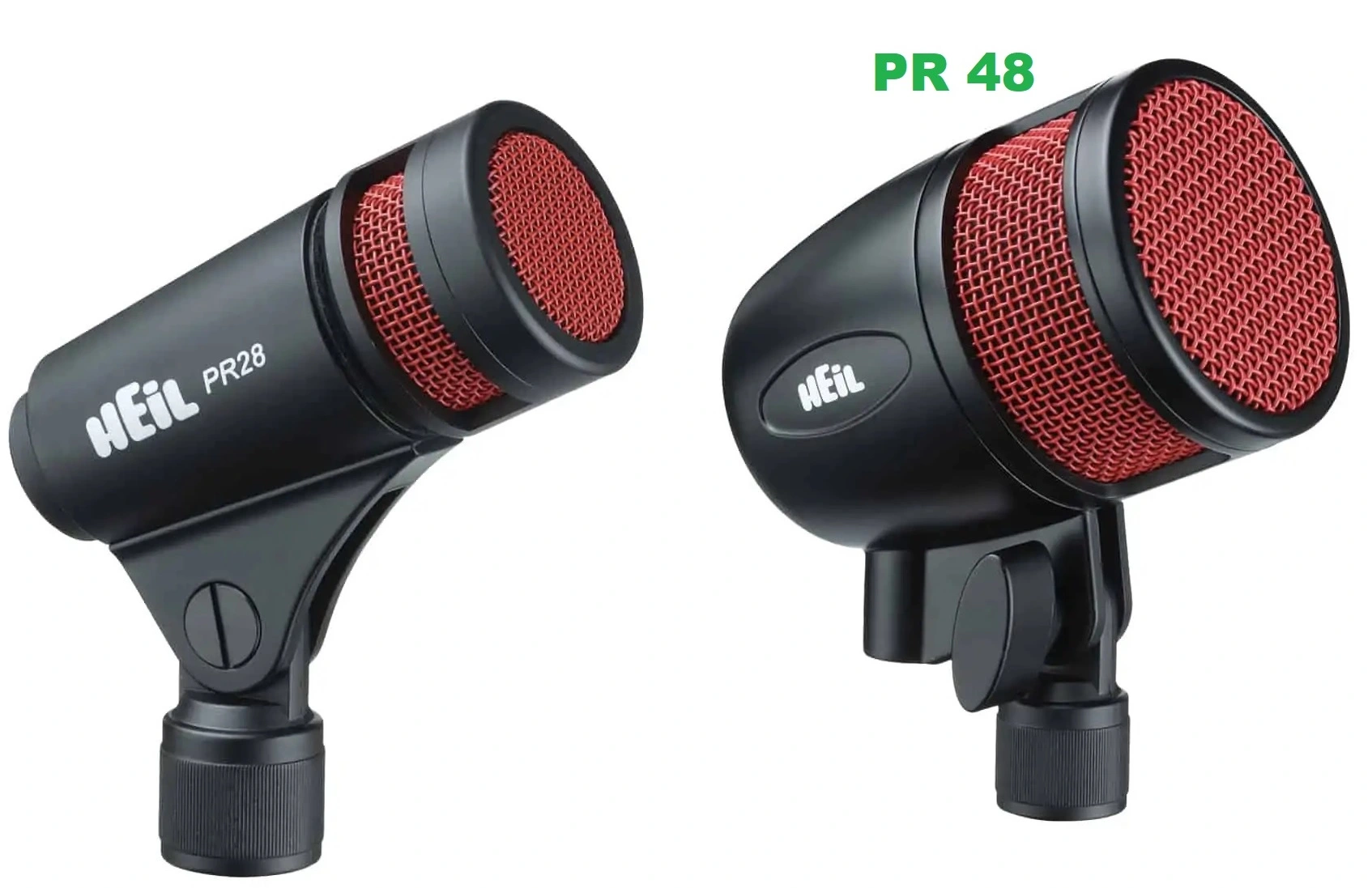

Wow @Steenamaroo ! ! This seems to be the "or similar" model ;) Going off your reply, I went over to Heil and found the PR 48 to be a perfect match - visually. The 28 has larger framework around the basket. Now, @Serendipity Records' pic. . . the mic looks a little oblong to me - just an illusion, I reckon.
It's on the far side of the camera view, so there's some lens distortion going on (that's why it looks oblong). But yeah, PR48 is the one I reckon, with the XLR input on the side. Anyway, I was really just curious, never even heard of Heil before. Thanks!
