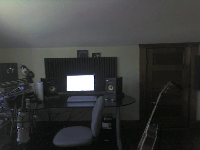

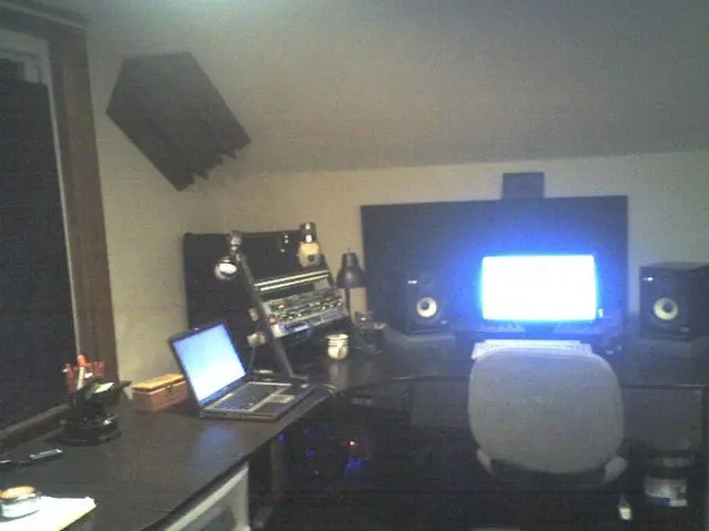

This is a cape style bedroom, 12x12x7, hardwood floor, horsehair plaster and lathe walls.
I've treated it a bit, albeit on a whim and not really knowing what I was doing with 4 strips of auralex foam, and an auralex basstrap in each corner.
When it comes time to sell the house, I don't mind redoing the walls, but I'd like to keep the wooden doors and molding ok.
This is both my tracking, and control room, and I only record singer/songwriters. Usually singing and playing at the same time. I get a sound that I like from isolated close miked tracks, but some of the stuff I've been doing lately will not allow that.
I'm recording three singers, two of which playing guitar, and one direct keyboard. I through If I give everyone their own condenser, I get absurd phase issues. If I use a single omni, in the middle, I get what I believe is the sound of the room. Everyone sounds much farther away from the mic than they actually are. Sounds a bit like sitting in the last row of a church. I'd like to tighten up the room so that I can record with an omni, and have it sound better.
Monitoring is boomy, probably because I bought foam basstraps from guitarcenter instead of ethans, or making my own. I'm just not a DIY kinda guy when it comes to hammers and nails and staples.
I was considering putting some auralex diffusers on the slants going up to the ceiling, but before I waste more money, I'd rather check with the experts. I don't mind dropping 3 or 4 hundred bucks, but if I'm going to do that, I want it to do what I want it to do...
I placed the bass traps about 3/4 the way up the corners... Would there be a point in buying 4 more to place below them going all the way down to the floor?

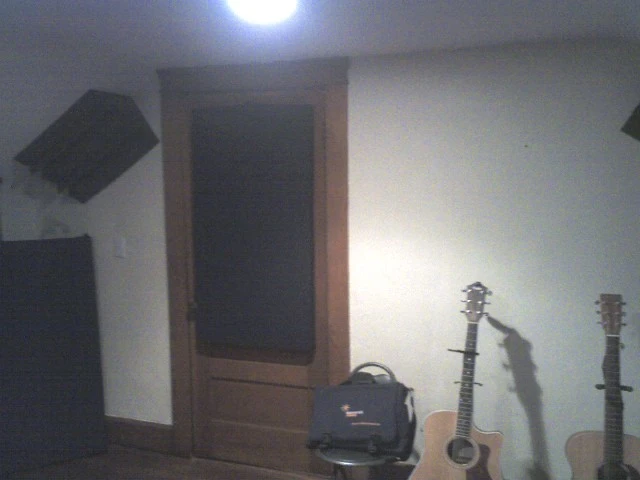

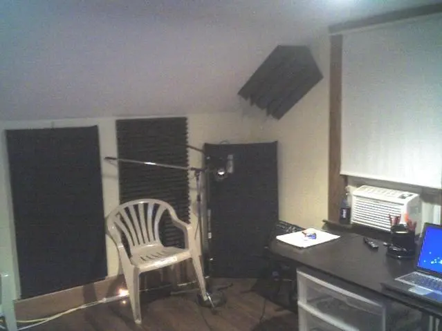

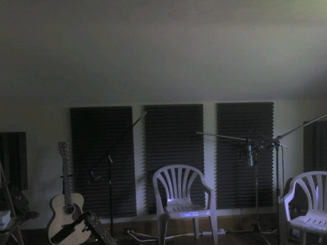

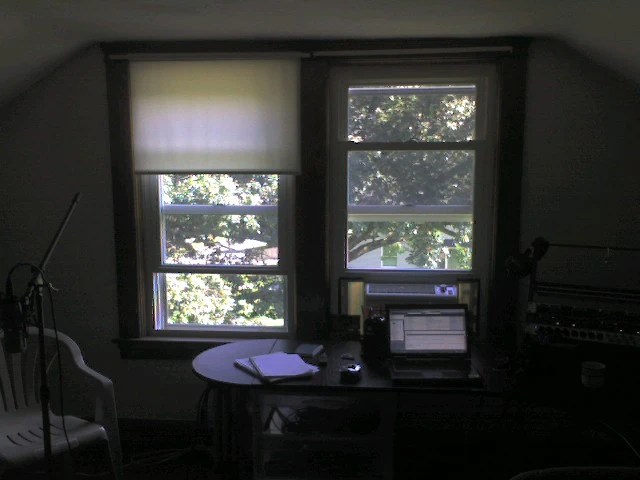

Because I can't leave things alone, I just took a trip to the insulation warehouse and picked up 12 sheets of 705. I'll replace the auralex bass traps with 4" 705 traps. should I leave the other auralex foam as is, or replace it with 705?

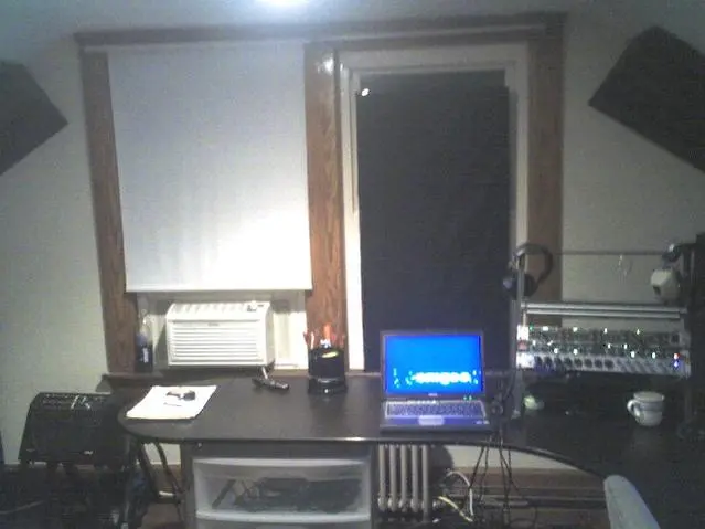

Heres what it looks like now.
The corner bass traps are 4" 705. The absorbtion on the window and door is 2". On the back wall, the center panel is 2" 705.
Unfortunatly, about $300 later, the room sounds about the same.. What am I missing?

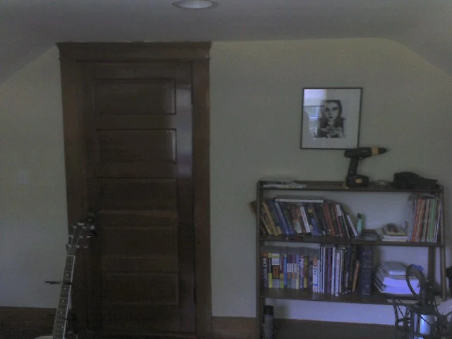

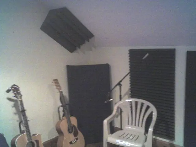

Here is the rest of the room.

If you are going to use an omni, you have to have a good sounding room, which juding from the recordings yours isnt necesarly. Try close micing with a condensor.
As to how to make your room sound better, Im sure someone else can pitch in with better advice. Just give it some time, this part of the forums moves slower than others sometimes.

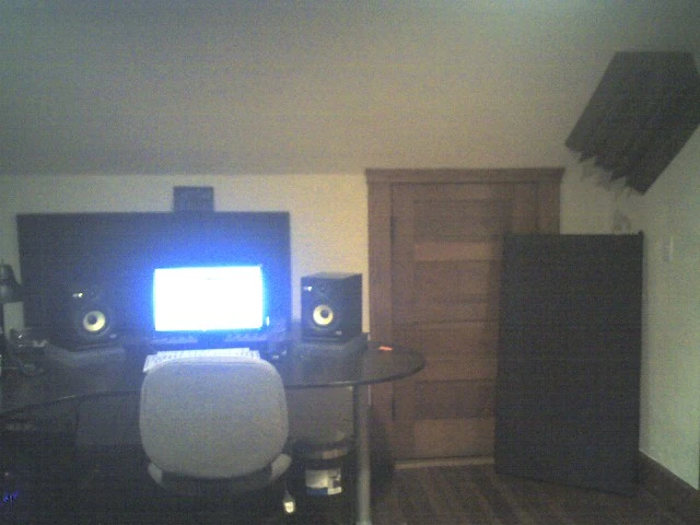

Presuming that the speakers you use are the KRKs. The ceiling slope above that position would be reflecting away over your head but the slope on the opposite side could be throwing that back down at you.
I bet that desk that the KRKs are on is causing all sorts of reflections back up to your ears. Also the speakers are not at ear-level.
I'm a firm believer in clouds, above both the mixing area and above the mic(s) in the recording area. Clouds are easy to make (or fairly inexpensive to buy) and hang and help a lot with hollow sounding rooms and should help with some boominess. If you decide to record drums they will definately make getting the cymbals to sound good much easier.

You know, it probably is the desk causing a lot of my problems.. I've got the KRKs up on foam pads, but They're still vibrating the desk. That may be my monitoring issue, and the clouds may help with the recording. There must be reflections coming off the slanted parts of the walls...

Well the sloped ceiling directing sound to the back wall is great, but the sloped ceiling directing from the back wall to you isn't. I'd add absorption to the back sloped ceiling and side first reflection points.

4" traps along both sloped ceilings and the 'corners between' them and the top ceiling.

I've got 4" 705 bass traps in the corners, and those auralex traps in the ceiling corners, I added absorption to the ceiling above the mix position and tracking position, and gave up on near fields entirely in favor of cans and VRM. On the ceiling I have no choice but to glue foam, since hanging fiberglass would rip down the lathe. I've added absorption to the back sloped ceiling and side reflection points. Just none of it seems to actually make any noticeable difference at all.

Post new pics man. Your lathe ceiling is supported by ceiling joists. Just a matter of finding them to mount panels to. The foam on the ceiling is not necessarily horrible for the purpose of controlling first reflections, but not ideal in any way. You are not even close to adding enough 'beneficial' room treatments to make a difference IMO. Are those KRK 5's? From my experience with them, I would say that is half of your problem right there. Use them for the tv in your bedroom...

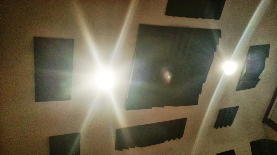

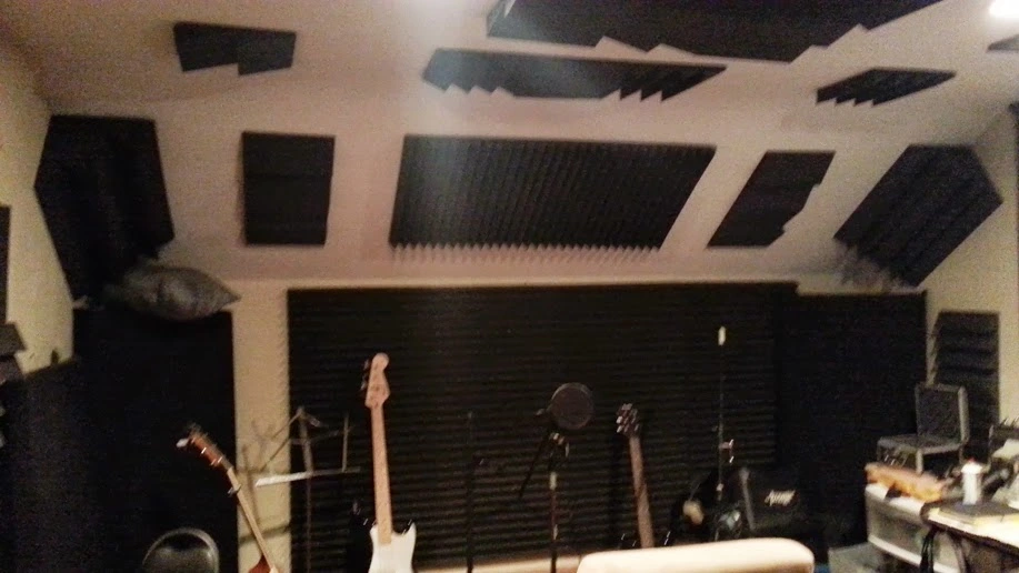

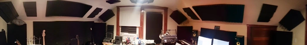

Here's what the room looks like 5 years later....
Ceiling
Back Wall
Panorama
I'm no longer using the monitors to make mixing decisions... just another set of speakers to listen with.
