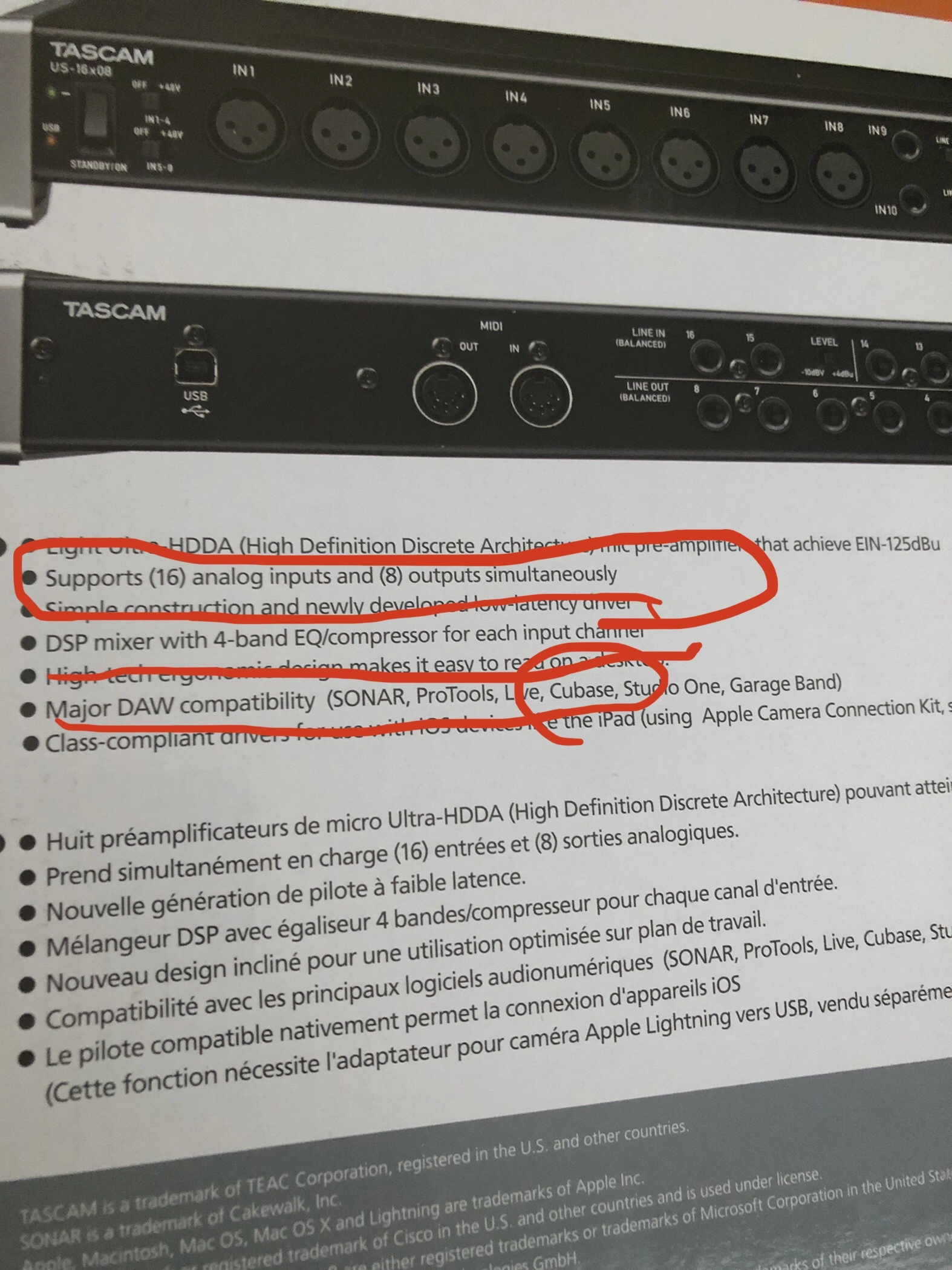

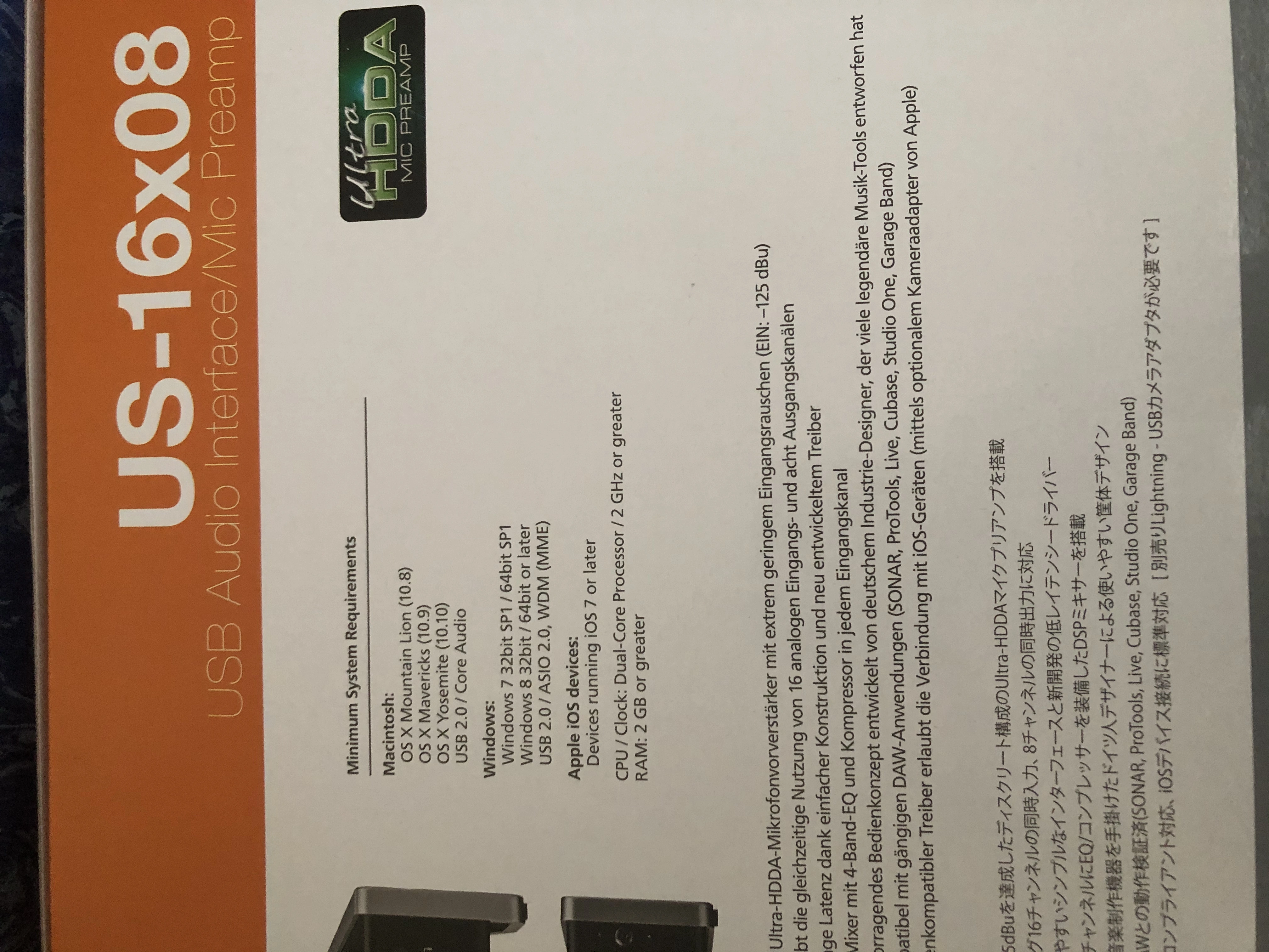

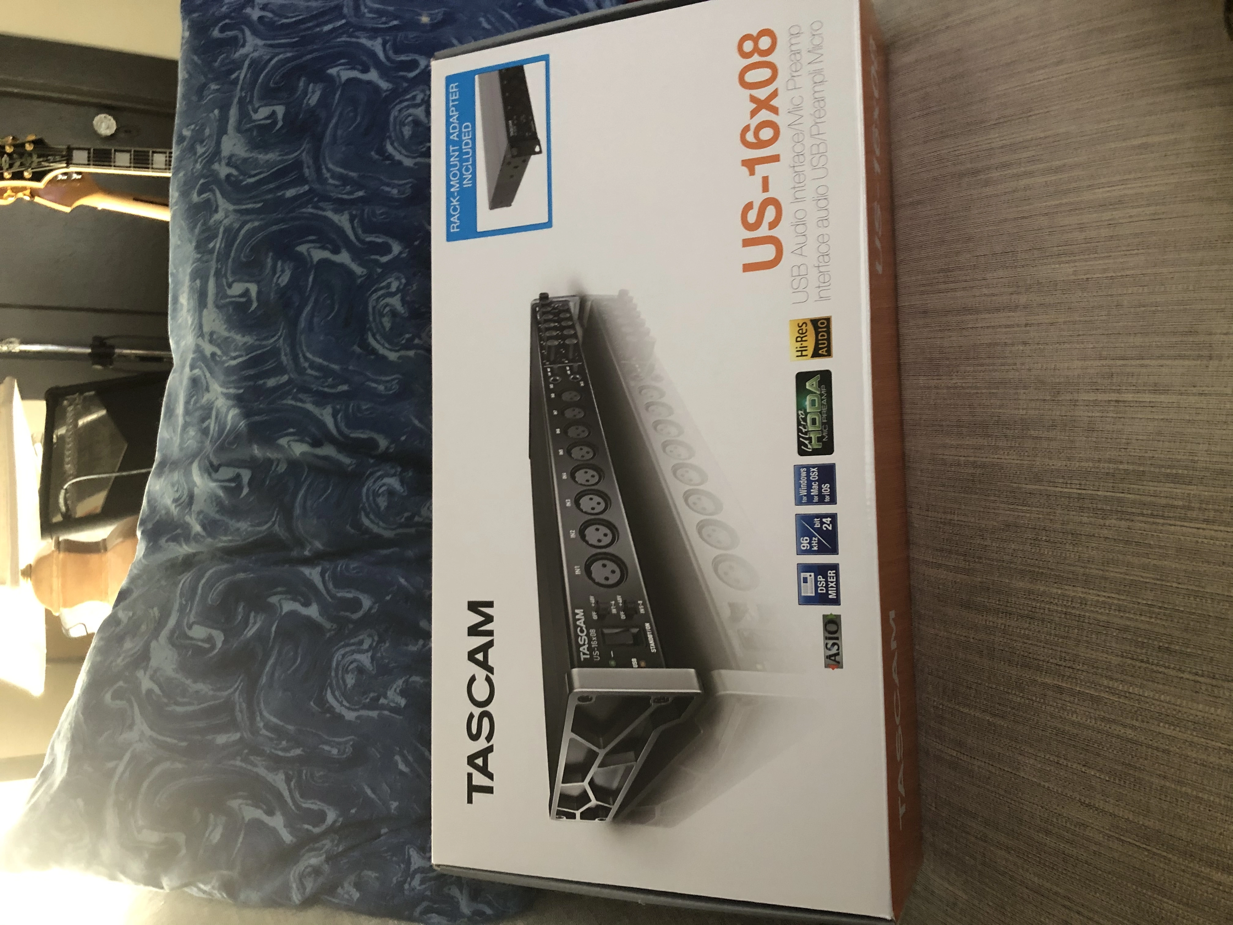

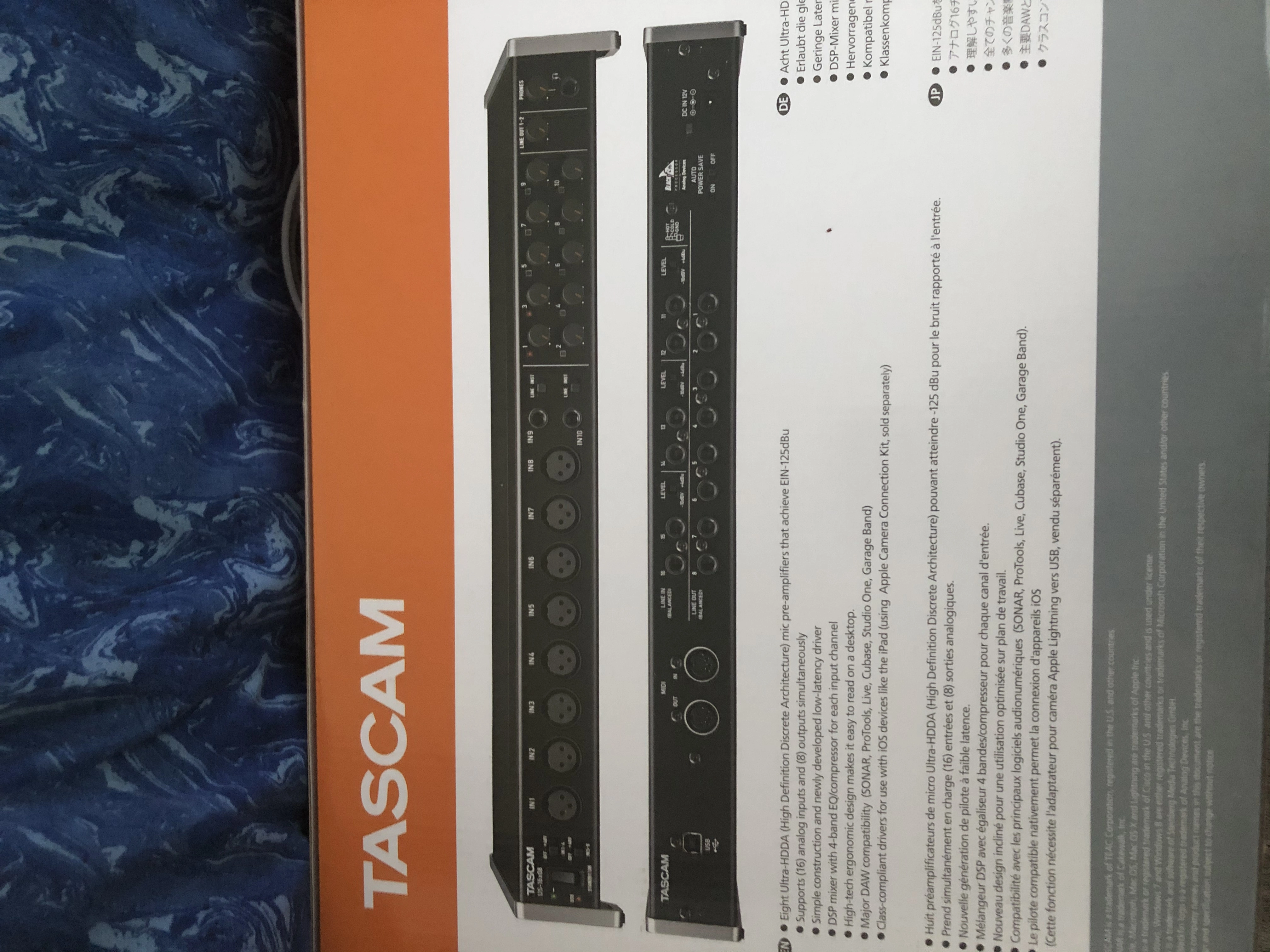

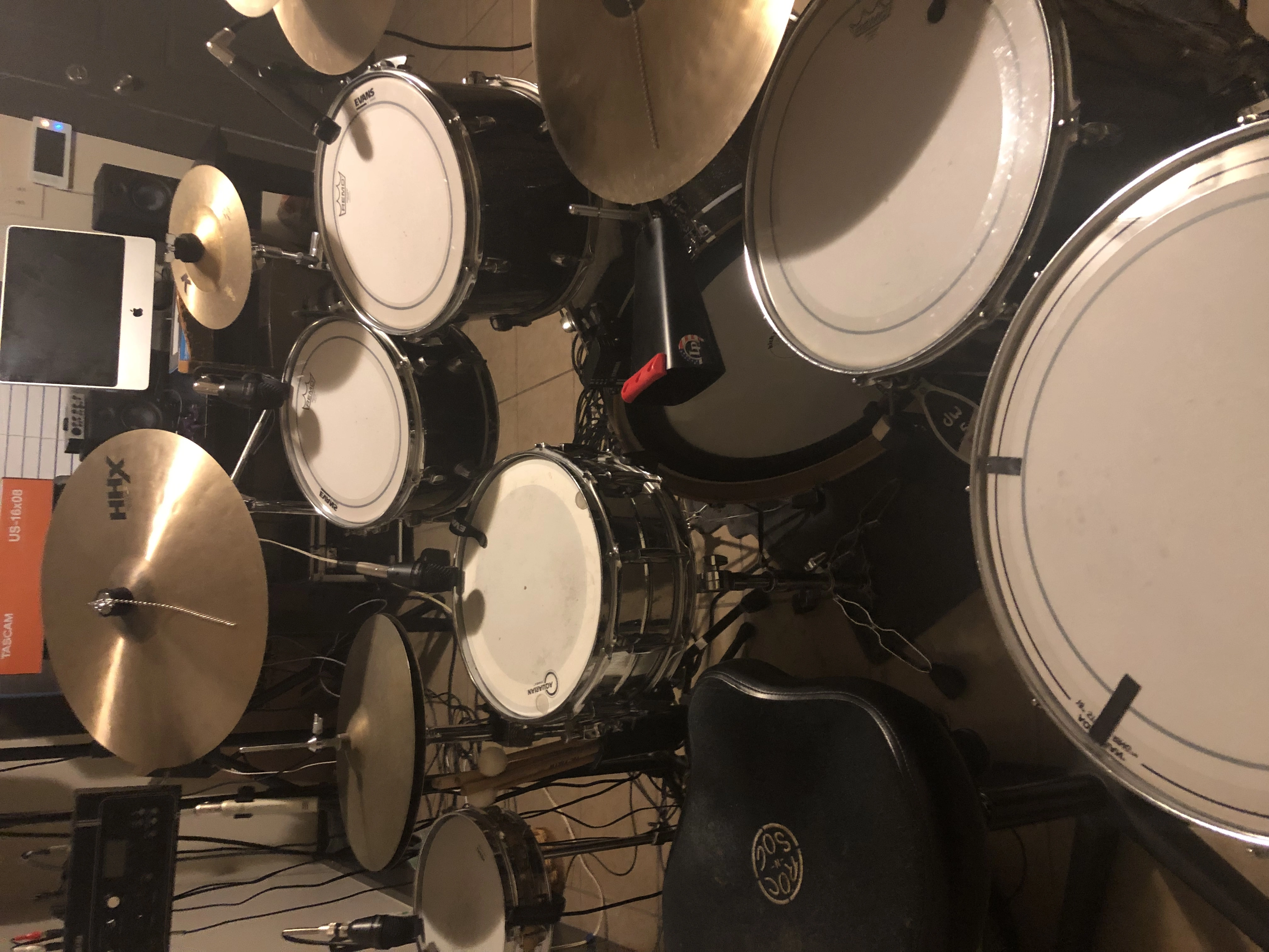

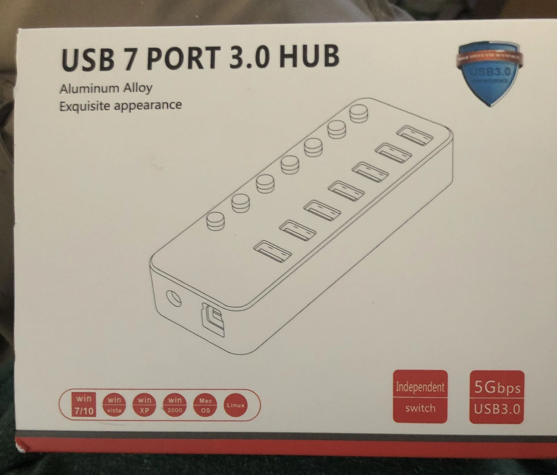

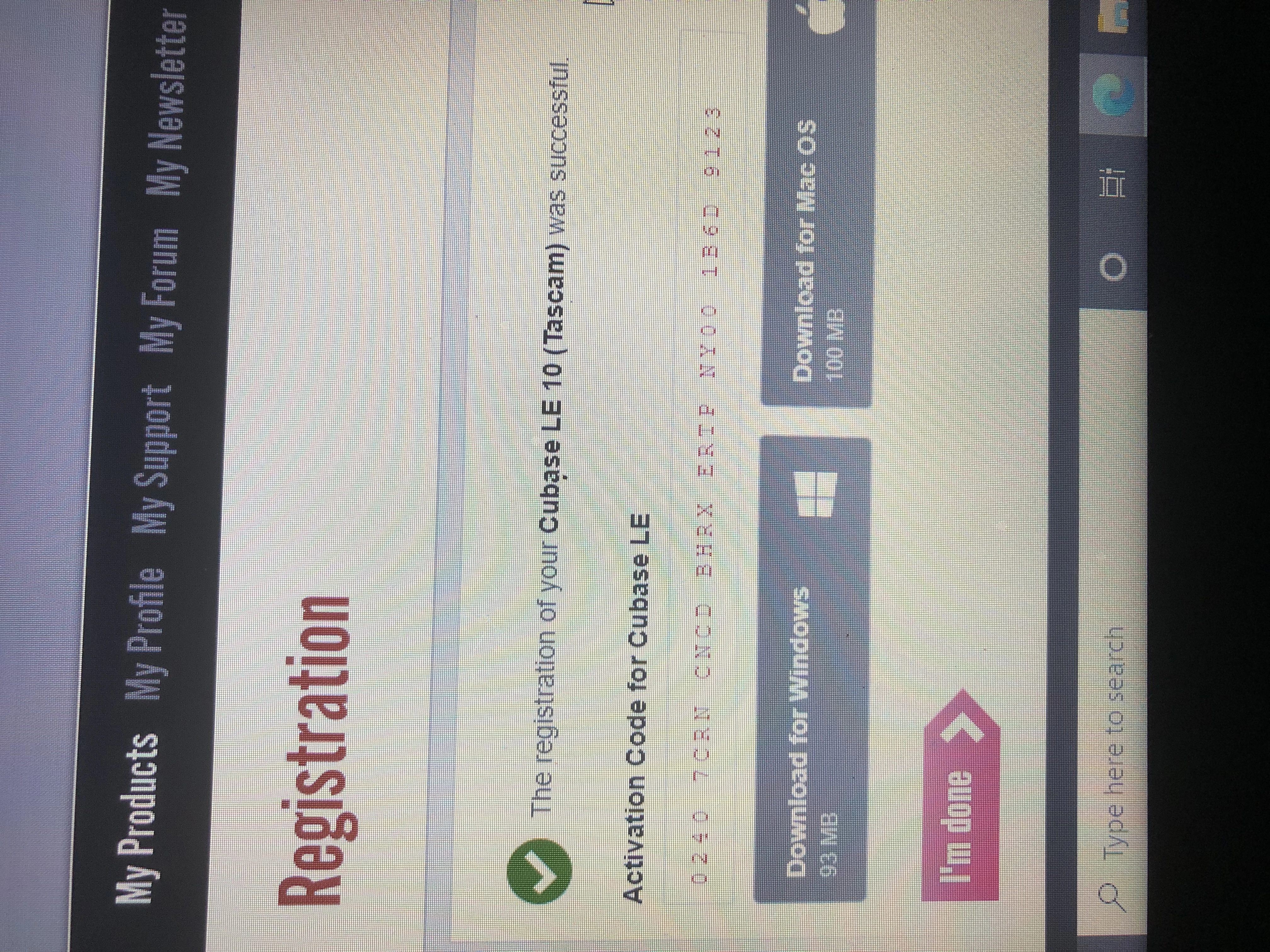

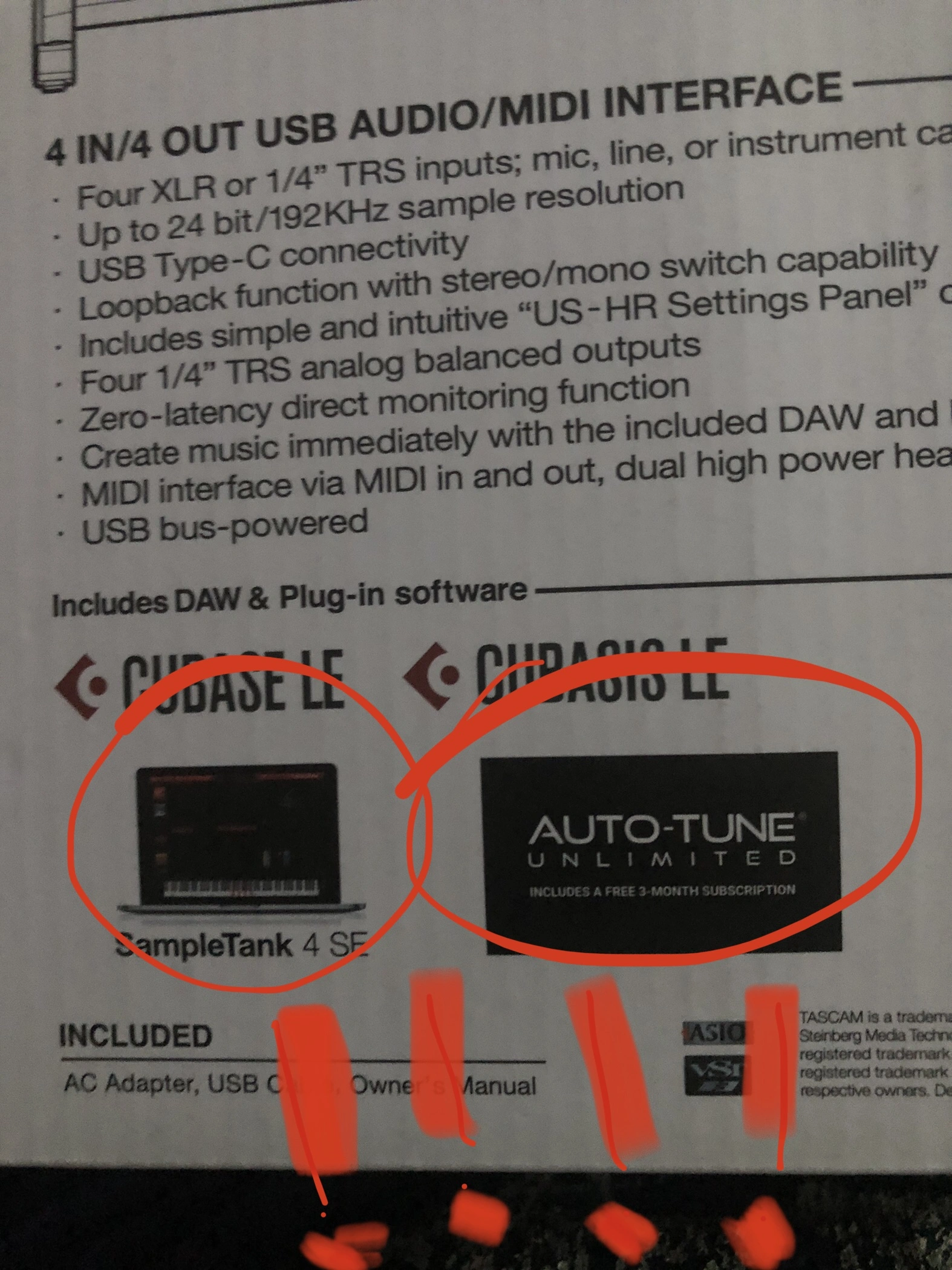

Hey-total newb to these forums but I am in a pickle! I bought a task him 16 X08 for my main pre-amp & bought the 4 x 4 task him because it was less money and I didn’t need a second 16x08… but now I’m faced with a huge problem.
I need to connect the task him 16 x 8 and the task him 04x04… I was told by the very curt gentleman at task him I have a couple options, the first being the ASI oh for all driver as I have a PC with 16 gigs of RAM, close to 5 yards I I was told by the very curt gentleman at task him I have a couple options, the first being the ASI oh for all driver as I have a PC with 16gb RAM, close to 5gHz and a 1.5TB SSD w/ a 2TB drive so my pc only has to run the software …
Other than that I was told I would have to send the line out one and two from the US 4 x 4 into inputs 11 and 12 on the 16 x 8… I have no idea if I would continue to get mono tracks but my drum kit right now requires 11 bare minimum XLR mic ins (which I SHOULD have on the 16 x 8 combined with the 04x04 But apparently only Apple computers will allow to preempt to be installed at once… I hate Apple so much because they are so goddamn expensive excuse my French I am poor as hell I am on disability I have autism and to make matters worse I barely make $700 a month USD… I had been saving for over a year to get these two preamp’s and now that they’re here a few months ago by and what I thought were my sure fire Bettbut apparently only Apple computers will allow two preamp‘s to be installed at once… I hate Apple so much because they are so goddamn expensive excuse my French I am poor as hell I am on disability I have autism and to make matters worse I barely make $700 a month USD… I had been saving for over a year to get these two preamp‘s and now that they’re here a few months ago by and what I thought were my “surefire bets”Are, with the exception of the 16 x 8, garbage considering I’ve gone past the period of time in which I could return it and get a refund… Sweetwater did not tell me I could not of them up together even when I asked them directly because I told them “this is what I need to do to microphone present wants the same but I don’t need to eat channels” Brian StokeAre, with the exception of the 16 x 8, garbage considering I’ve gone past the period of time in which I could return it and get a refund… Sweetwater did not tell me I could not of them up together even when I asked them directly because I told Sweetwater personally what I need to do to use the two tascam pres @ the same time but I *don’t need nor can afford* two 8-channel pres! I said all that & more. “You are a-okay my man, those are just the same model one has eight channels and one has four you can plug them both into the same computer as long as it has the right specifications and a i5 - i7 - Plus I would recommend getting a USB 3.0 hub, that could make it even easier just make sure it has the SS 3.0 or C in place but still they’re both the same model the drivers will match your PC you’ll be able to run this and multiple other programs with the specifications you’ve given me! If only Apple made computers this powerful …” -that was from a recorded conversation with me and Ben Stokes of Sweetwater. I will always remember his name and not for a good reason :(
I’m sorry about the rant, that’s the hardest part of being on the spectrum for me…blabbing on & on.
But this - this is potentially a catastrophe for me as I cannot return or refund or exchange for anything (credit or refund or whatever) so…
Either I’m stuck with a piece of trash or there’s got to be away!
Hey now! Hep me! Hep me! ?????‍?

You should be able to run 8 mics into the 16x08, and 3 mics into the 4x4, then use the 3 line-outs from the 4x4 to 3 of the line-ins of the 16x08.
