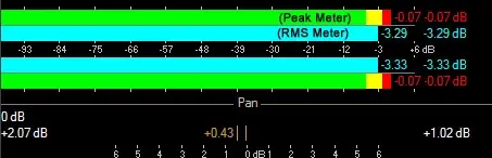

As a sidenote - Here's some "maximum potential volume" for you... This engineer has L2-itis. He wanted to "get it close for the mastering guy." I actually told the client that I refuse to play this on my speakers (at ANY level) for fear of damage. This is a hack job of hack jobs that any bit-hoarder should be envious of... Feast your eyes on the RMS levels and imagine how horrific it sounds...
:eek: HolyWTF? I can't really imagine how this sounds, it would probably be approaching pink noise or sumpin. I can see why you would turn down this job; I mean, what could you possible do. -3.3db definitely gives me something to shoot for now. :D
