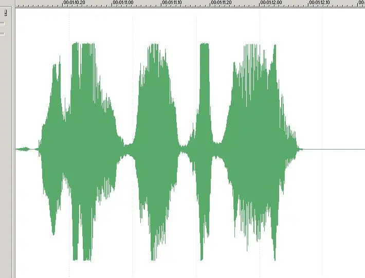

wellll, it seems like after all this time i've noticed something a little sketchy.
C1, -10 (sometimes -20) db pad, DMP2, delta44, vegas 4.0
i've just started noticing that sometimes, the waveform created when people sing/rap has like a box at the top/bottom of it. aka, it WONT go past a certain line in the picture. Kina like something is clipping BEFORE it is actually clipping (before 0). I don't think I hear any problems there though (audible)...however i may be wrong.
2nd, I noticed that when a girl sings, and pours out her heart close to the mic - loud and high for example, the waveform gets HUGE either on the bottom OR the top. Not both, only one side will get bigger. might I remind you this is a mono recorded source.....anyway what is this telling me? I guess I never really stopped to think that the picture could be telling me more than just "this is louder here" - is it charting freaq. or something as well??? or does this just mean, again, that the mic may be overloaded?

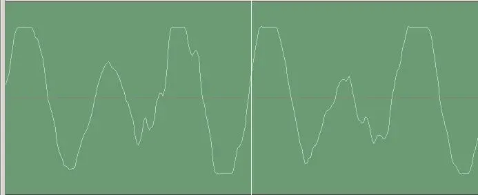

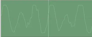

squarish
here is one that is kinda squarish. This is the best example I could find at the moment - but i didnt look to hard.
anyway, it prooves my point. Just like the sound wont go past a certain level...hmmmmm

Is it actually squared off there or really dense.... open the waveform up, spead it out some more, a lot more, and repost it. I see it look like that all the time, what I'm talking about is when I spread it way out they go up and sqaure off, almost like a limiter was on it.

peep this zoomed picture.
Those flat peaks look like clips to my amateur eyes. And it's hard to believe they don't sound bad.
I find it hard to imagine that a mic would induce limiting, and if it is the mic that is clipping then by the look of those pics it would sound god-damned awful, in which case I imagine you would have made that clear.
If everything is sounding OK, then another alternative is that it is just a problem in the visual display of the waveforms.
:cool:
doesn't sound bad to me. no effects, tested with headphones on as well - turns out I do notice MINIMAL distortion. like, it really just sounds like rhaspy voice...but I think it probably is distortion. Anyway, it's SO minimal, it really just sounds good if it is. anyway, it's a pretty crunkt rap song so all the better..
