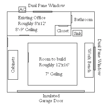

I have attached a drawing of what I am planning to build for the garage.
With all of that in Mind....
I looked up STC's and what I have in mind with no insulation looks pretty decent around and STC of 50. http://www.saecollege.de/reference_material/
The drum noise coming from the office will partly go through the walls outside and partly go inside the large garage area surrounding my future mixing room.
Will I be better protected in the Mixing Room because of the sound trying to escape out of the garage quicker than trying to enter my Mixing Room?
Should I be fine without insulation?

Drums are about 100 to 110 dbs. If you are mainly just concerned with being able to mix in the room,you can get away with your design and standard insulation because you wont be tracking drums while you are mixing.
To silence the drums,you will need a bunch of mass and no windows, plus an equally heavy ceiling and thick solid core doors to silence drums completely. It helps if they are in another room plus some airspace before your tracking room.
You may want to build to suit what you are going to use the room for 90 percent of the time because to tame 100 or so dbs is gonna cost you.
I have just built a studio with vocal booth, drum room and control room / live room with double walls - double doors /soundlocks/ double 5/8ths sheetrock walls and seperate ceilings totally caulked airtight with double 3/8th glass and the whole nine yards and I can still hear some drums. I spent over $30k. with acoustic panels and all.
My experiance anyway.
