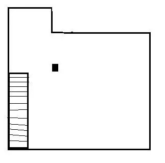

this is pretty much what the place looks like.
pretty much about 100 sq. meters
stairs are on the left, and we're thinking about seperating it where the pillar is the bottom right being the recording room with all the equipment, and the top right the control room.
we're gonna use plasterboards and mineral wool, to build the walls and soundproof em.
i don't think we're gonna have a problem with the neighbors cause on top of us are a couple of stores and on the 1rst floor are apartments, and we're in the basement
and again thanks for the help

you should try your best not to make the room not have perfectly parallel walls...
that'll result in a lot of standing waves...which are bad.
Ah, so the structure is already there. I perceived "from the ground up" as you may be building a new stand-alone structure with a studio inside. Well, it seems that not much sound is going to bother outsiders from the floor and walls, anyway :) I would guess it is masonry construction, the walls (took me a long time to come to that conclusion, btw :D ) so you are going to have a little reverb chamber until you build the inner walls, floor and ceiling, if that is your intent. Wish I had your problem :)
