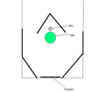

I paid about 40 for 4 twin size sheets :o. It was a hasty decision, but I have the receipt :). So I was thinking of getting 1 pack of the 703 panels, surrounding the mic in front, and covering the walls behind me. Sound good? Also, I can't really drill holes in my walls as I am renting. What would be a good way to mount them. Does the setup below look good? Do you think I can acomplish this with 1 pack? The walls are 8' high. The Wall behind me is less than 4' wide. Thanks in advance.

That's 7 panels.
Is it enough to just put them behind me at mic level or should I consider the ceiling corners, floor corners, etc. (i.e. most of the surface area behind me)?
Thanks.

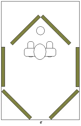

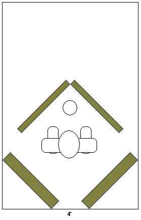

This is my suggestion. You could place them like my first suggestion, or double 2 panels up fo bass traps. You also have the ceiling and floor to worry about.
Whatever you do, i'd keep the floor reflective, if you can.
The panels behind the mic could probably be keep half sized, 2'x2', leaving the other halfs to be used on the ceiling. This should definitely be enough. I'd buy two more packs and treat your control room also.
Instead you could buy the 3.5" bulk cotton bass absorber from Brian(Bpape), which has enough material for 16 4'x2' panels. That comes to $187.87 including shipping.
With that, you could have 6 in this room and 10 in the control room, 1 placed in each of the 4 corners, 2 on the back wall, 2 on the side walls, one on front wall(horizontally behind monitors), and 1 on the ceiling.
