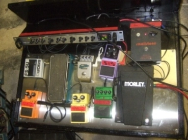

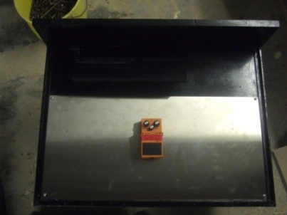

hi! if you remember the thread i started about two weeks ago asking whether magnets would effect (haha) pedals, then this might interest you... this is what me and a friend came up with for my new pedal board, with some pictures to show all you lovely people :)

did you test the magnets? what's the v shaped board above the sheet metal?
and a few more.....

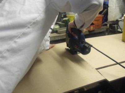

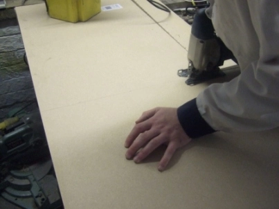

unfortunately, i only started taking photos on the day we built the lid :p so they're not very exciting. but you can see what we actually put together at least. the magnets are very strong - that morley wah pedal is difficult to move! i gigged with it tonight and everything seems fine. the magnets are industrial stregnth magnets used to pull beer cans and the like along conveyer belts. my friends dad donated the magnets, so the whole thing came to about £15 ($30?) in wood, and not much more. we had a lot of fun putting it together (just trying to convince his girlfriend to buy some bass pedals so we have an excuse to play with power tools again :p)

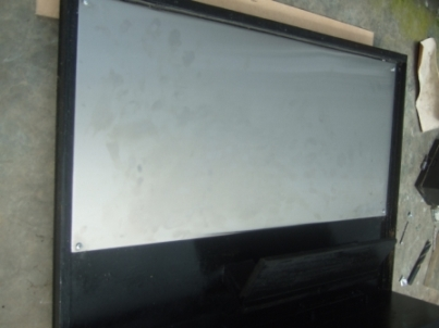

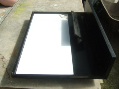

did you test the magnets? what's the little v above the sheet metal?
the little V is just before we took the protective plastic off - daves dad also cuts metal as part of his job - just gave him the measurements we wanted for stainless steel and came back the next day with it cut to the millimeter. we had some interesting experiments with the metal on top - we realised that we Didn't want to use a magnetic metal for the top, so that the force the magnets were putting out wasn't simply being ferried into the metal put on top of it, but was felt by the pedals. similar to how you can 'magically' pull a coin along a table by holding a magnet underneath it - if wood was magnetic, that wouldn't work :p we put a piece of magnetic metal (i forget which) underneath, so that we didn't get to a gig to find it stuck to the side of the van, or stuck to the floor if a venue had a metal floor, or anything :p
Andrew.
i was referring to the board that your rack unit is mounted to. looks cool man. how expensive are the magnets? i think you have a good product idea here. better run with it before someone else does.

i'm not sure how much the magnets were - they were very generously donated. we used 3 rows of 8 - that's 24 magnets. i don't think they'd have to be quite as strong as the ones we used, but, like i said before, those pedals hadn't moved a centimeter from where they were when i put them on before the gig, and i'm looking at them now, and they're still sat exactly where i put them.
Many/most formulations of stainless steel are non magnetic. It was a surprise to me when I found that out.
haha, we had to do our homework for that. we didn't actually Want that piece of metal to be magnetic, otherwise it'd act as a "keeper", and use most of the magnets "magnetism" (i don't know what the real word is, if that isn't it) on the metal, and exert next to nothing on the actual pedals, so it'd be useless. i suppose a better way of saying it would be that we could have used pretty much anything that wasn't magnetic in place of that piece of metal, but the thinner and stronger the better, so we went for stainless steel, especially because we could so easily get it.
the underneath has a steel (magnetic) sheet - to make sure we didn't get the whole thing stuck to the floor of any vans, haha :P
