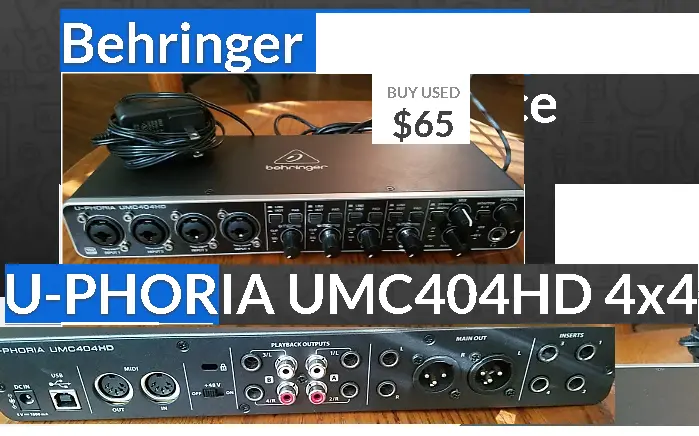

Headphone amps, my 2 cents is they work or they suck, my interface headphone amp sounded close to my Grace Design headphone amp but I also have the Behringer Powerplay 8channel?6ch?headphone amp mentioned too and its a cool unit and was only $60 used. Sounded damn good though for playbacks etc. Has some good I/O options. I have the various headphone ohms too....32...28...80...250...they all work ok, though the volume drops noticeably with the higher headphone ohm, so a beefier headphone amp can help with the higher ohm sets.
always outgrew the 2 input interfaces quickly, and believe in getting one with more inputs.
also prefer a walwart/real ac power not USB. Running the whole interface with 500ma of USB power to the headphone amp, preamps, phantom power, and the rest is a lot of stuff needing to share the small 5vdc/ 500ma. some units can do both, USB and/or wall power for portability and home.

CoolCat: Is that UMC404HD the unit you have? My main headphones currently are AKG K182's (32 Ohm/112 dB@1V) so low impedance here... btw. according to a user comment on youtube (YouTube) the 404 DOES also work with only USB power. Maybe the external PS option is there if you for some reason want to avoid drawing the power through the USB, dunno. From what I've gathered the lower-end UMC's (202 and 204) are basically the same unit, just with less inputs/outputs.
