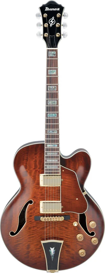

I think he has one like the first guitar on this page-click on the image and it expands to HUGE. Theres a tune-o-matic thats on a floating wooden bridge.
My mandolins have the same setup as far as floating bridge-I use the same method Farview stated to set the 12th fret harmonic and note-but still on them it is a pain to set up so you should take it to a repairman and only change one string at a time so it doesn't get knocked out of whack.
Ibanez Artcore guitars
Hi, thanks for your replies. I may take this to a luthier. Here is a pic of the model I bought. Gorgeous guitar for the money. When it's set up properly, it will be great. Action is nice, nice tone.
