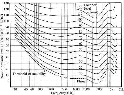

Here is a graph of "typical" human hearing response curve / dB level.
This is whal the "Loudness" button is "supposed" to compensate for.

tarnationsauce2 said:
Humans have a hard time hearing low frequencies, and certain high frequencies at certain sound levels.
Do a search for Fletcher-Munson equal loudness on Google.
one of the best things that ever happened for my EQing was the discovery of Fletcher-Munson
