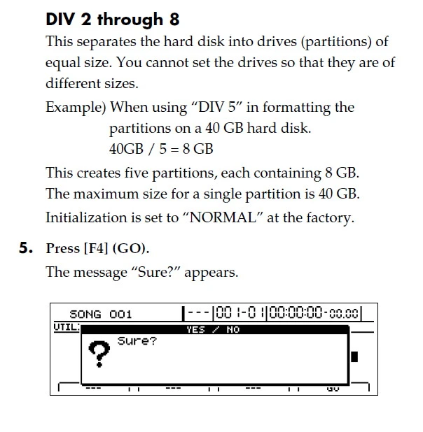

Do you know if the the BR1600 hard drive is partitioned to several smaller sections? My own Tascam 2488NEO has a partitioned 80G drive that can show 'Full' for a partition, but the entire drive isn't full.
The 2488NEO also has a 'cleanup' utility that gets rid of the unused edits and/or deletions which can free up space.

I grabbed the BR1600 pdf. Evidently the HD can be partitioned during a format with up to 8 partitions, so what you actually have could be considerably less than the full 80Gigs (are you 100% sure you have the 80Gig HD?). You can view the partitions if any as described in the manual under 'Performing hard disk operations' and also as well change to a different partition.

Thanks for that arcaxis..........I definitely have the 80GB version as opposed to the 40 GB version. It was a later version sold by Boss and the one I bought. Gonna study that manual a bit more I think. I was unaware of hard drive partitions. There's less than an hours worth of recorded tracks on the hard drive if that is anything to go by. And I get the message 'HDD full delete some memory e.t.c
