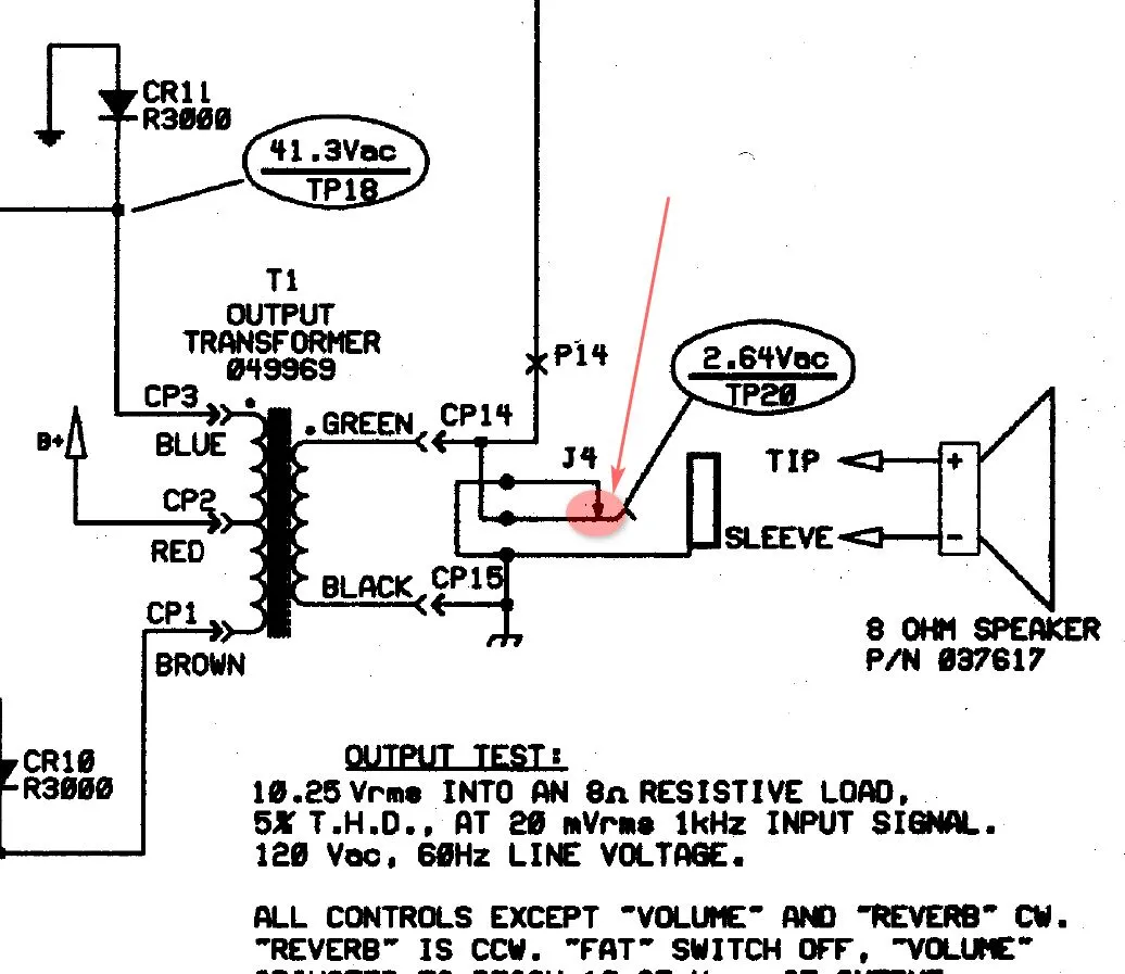

Would highly recommend having the BJ amp turned off when connecting or disconnecting the cables. Be sure all is plugged in before powering the amp up. Tube amps don't like having no load on the output transformer and could be damaged if powered and you happen to wail a chord through the amp with no load. The amp does have 'protection' in the speaker jack if just the speaker is unplugged, but not for an open ended cable plugged into it.

Would highly recommend having the BJ amp turned off when connecting or disconnecting the cables. Be sure all is plugged in before powering the amp up. Tube amps don't like having no load on the output transformer and could be damaged if powered.
