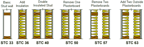

The BEST bang for the buck assembly is a TWO leaf MASS AIR MASS system with one leaf decoupled from the other. That can be accomplished in various ways. However, there is many many details, and is impossible to cover in a short reply.
