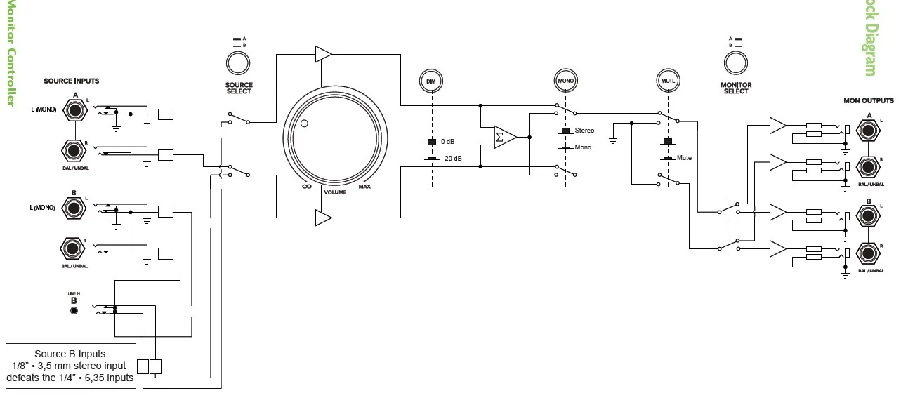

Being a passive device, the BK will likely lose some signal going through it and looking at the block diagram in the manual suggests its inputs are not balanced which may lose another 6 dB or so from the balanced out of the 8i6 even if TRS cables are used. I'm kinda thinking the 8i6 may not have the headroom to drive the monitors with the attenuation of the BK between the 8i6 and the monitors and limits/clips. The 'Dim' button appears to pad the signal another 20dB. I assume that's not enabled(?). It might be interesting to try the monitors with and without the BK at the same volume setting on the 8i6 and see if there's a notable difference.

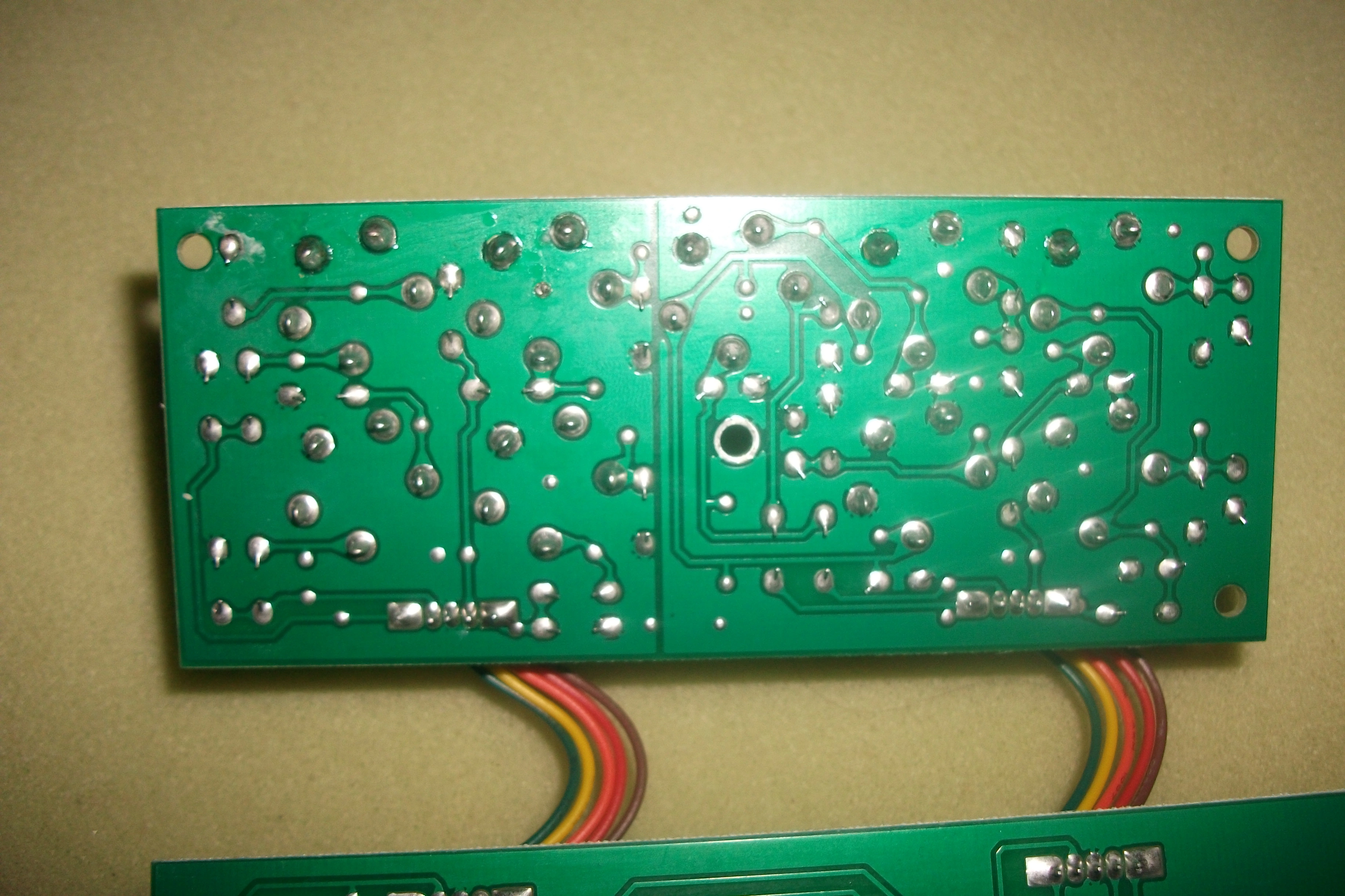

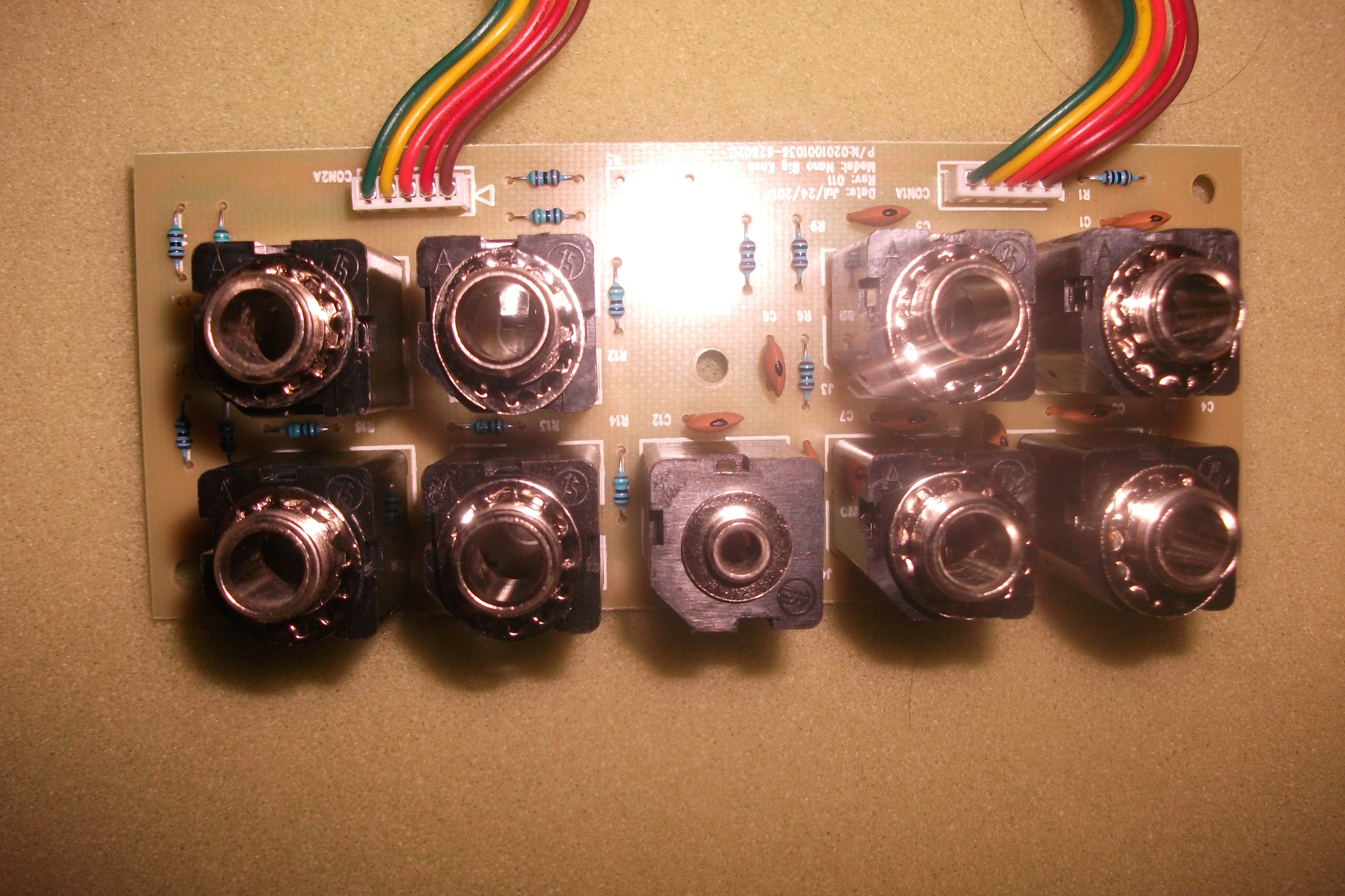

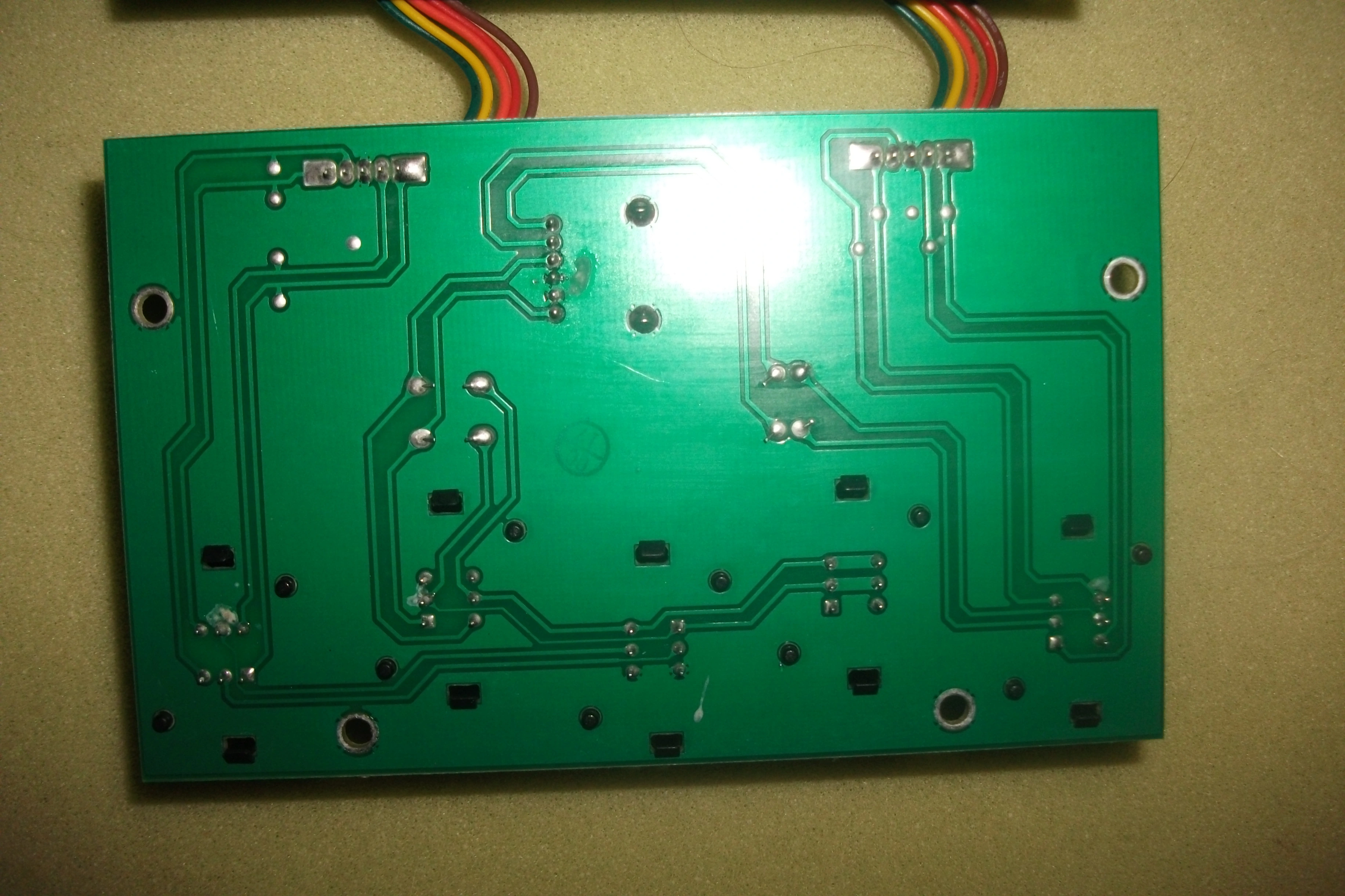

I have had the BK apart and it is nicely made (pickies in due course) for the price. Found the 1k Rs, so not an aberration but actual physical resistors..FFS why? there are also some wee bits that LOOK like resistors but are actually shorting links. Some ceramic caps as well, RF filters? Yes, two electrolytics feeding the 'top' of the rather uninspiring stereo pot. 10uF, a value that won't enamour the box to the audiophools but I doubt anyone could hear any LF distortion at these signal voltages.

Some more info Mike and some smudges.
I checked the input impedance and insertion loss..MO as per,
1kHz out of my ZED10 (hefty level.low z) and then into 'A' input. With VC at max, the loss was 1.9dB. Just audible on an A/B but hardly a bother?
My test kit situation is dire at the moment so an input Z test took the form of reading the volt drop across a 5k6 in series with the tip circuit. Bit o 'rithmetic gave me 10.53k very close to the pot value as would be expected.
That means that the output resistance could be as high as almost 3k and so cables to monitors should be as short as reasonably possible. Mine fortunately can be and are less than 2mtrs.

Hey Dave, the input jacks as shown in the BK diagrams seem to be remiss of the sleeve connections like as they are shown on the output side jacks. This would suggest the BK is using the ring connection of the input jack as the signal low and 'ground' internal to the BK. Probably done this way to accommodate both TS and TRS type cables(?) This 'ground' connects through to the outputs where as you note the ring is connected through a resistor to create an impedance 'balanced' connection. I kinda think if the ring wire in the cables were lifted the signal low may not have a path to the output jacks since it appears the sleeve of the input jack is not used. Maybe you can ohm this out to verify the non-connection of the sleeve in the input jacks? The other potential problem lifting the ring wire which kind of provides a ground and signal through path is that the sleeve of the input jack on my JBL monitor is connected internally to AC mains ground on the IEC connector block. This could provide a not so good ground signal path between the monitors and the 8i6 or it may present some sort of undesirable ground loop.

Mark, a 'block diagram' is not a schematic. But do not worry, the sleeves of all the jacks connect to each other via the chassis.

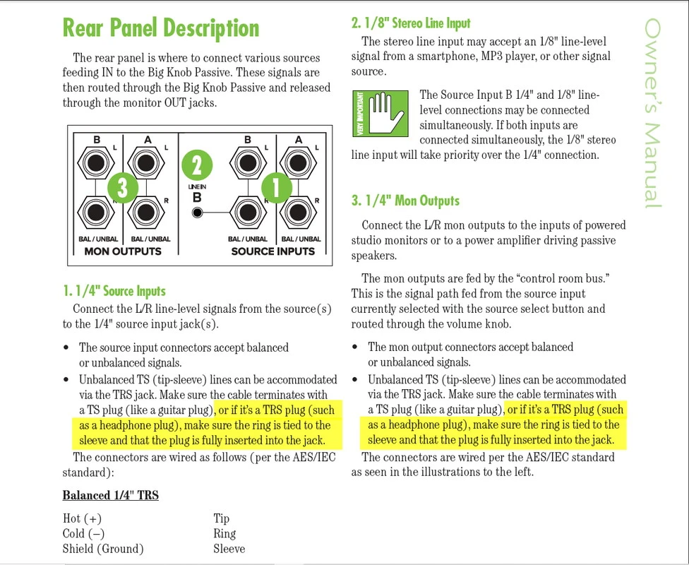

It seems that Mackies manual even states that if using TRS cables the 'ring' needs to be tied to the 'sleeve', which essentially makes the cable a TS cable to fudge the unbalanced connection for the BK :facepalm:
And yes Dave I fully realize a block diagram is not a schematic, but if the input jack sleeves are grounded (and it sounds as if they may be through the chassis), the block diagram provided lacks consistency as they've shown the output jacks properly with the sleeve connection and neglected to do the same for the input jacks.
