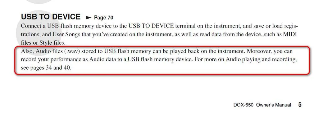

Have you tried recording to a USB stick? It records as a pristine, no loss wav file that can be easily transferred/imported to Audacity or other DAW. This works well on a Yamaha keyboard I have.

yep record audio to USB stick is the ticket...for that unit
From the Yamaha site...
DGX650 :USB Audio Recording
1) Connect the USB flash memory to the “USB TO DEVICE” terminal.
2) Press the [SONG/AUDIO] button once or twice to call up the AUDIO SELECT display for Audio recording.
3) To record a new Audio file select “000 New Audio.”
Note: if you select a file that contains previously recorded data the previous data will be overwritten and lost.
4) Press the [REC] button to be ready for recording.
5) Press the [EXECUTE] button to start recording, then play the keyboard.
6) After you finish the performance, press the [EXECUTE] button or [REC] button to stop recording.
Note : the audio file will automatically be saved as “UserAudioxxx” in a folder labeled “USER FILES” which will be created on the USB flash device.
7) To hear the recorded performance pres the [START/STOP] button.
