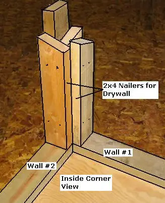

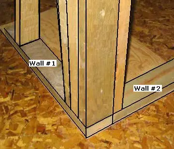

Hi I'm just getting ready to build my drum room and need some advise on how to corner my wall frames together. Should I do it like the attached images or is there a better, more simple way?
Thanks.

Oh yea. The only reason I'm asking this is because I was mainly wondering if applying this triple stud system in the corners would effect the sound escaping or something like that somehow. I have done my research for basic frame building so I'm not just jumping on this board asking question without doing a bit of homework.
Any insight would be greatly appreciated.
Thanks.
looks good to me

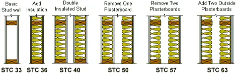

I'm making a 6 foot by 9 foot floor. Those calculations will be on the "Inside of the drum booth" and the ceiling will probably be 7 1/2 or 8 foot tall. I will be using a mass-spring-mass type wall system using staggered studs and a 3' spring gap. The thickest plasterboard I can get. Using green Glue to sandwich them together. Exactly like the far right design in the attached pic. The floor will be raised using U-boats or something similar to cut down on cost and using MDF,Green Glue,Plasterboard and then whatever I decide on for the nice finish floor. I will most probably assemble the ceiling the same way. I'm think of leaving a 1/4 gap at the top and bottom of my walls to stuff some foam rods in and sealing it up with some Everflex AC50 and every other place needed. The build will take place on my roof top terrace. The structure will defiantly hold. I live with an architect so I have been given the all clear. My only concerns are A/C and the doors. I don't know what's best for A/C and I am NOT going to skimp out on the doors. Tha's where I will spend the money if I have to. I want to get Proper Sound doors. I don't see the point in building perfect walls just to have a shitty door.
:confused: How does one get a THREE FOOT spring gap in a STAGGERED STUD design. Unless the plates are 3' wide!!:eek::confused:;)
