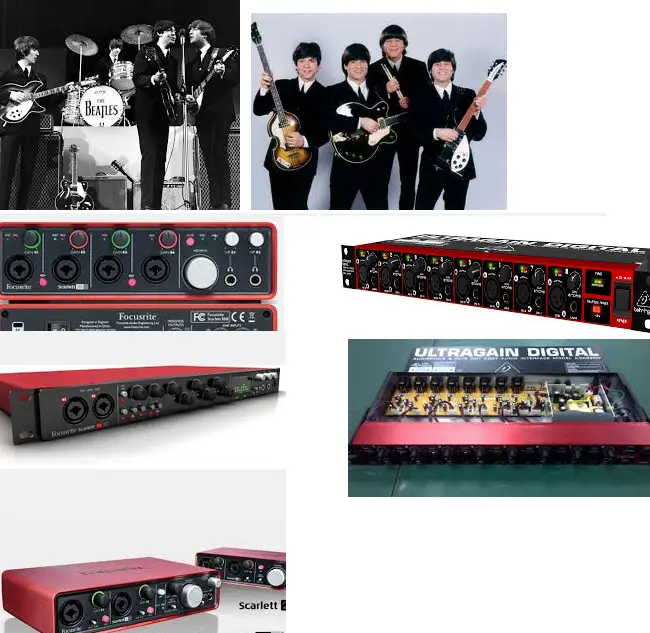

The newer ada8200 is supposed to be much better.
You have to love Behringer, doing the red faceplate (just like Focusrite Scarlett popular series).
I guess you cant copyright colors, lol, but its so obvious they just copy whatevers successful that month.....and they've done well following the trends and sales though, got to give old Behringer that. I've read the newer Behringer stuff stands up well in the blind shootouts too. Like the convertors and such.... so save some money, is always good in my opinion.
