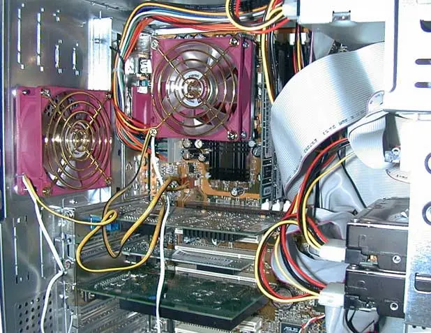

Good thread. I mounted a 8 > 6cm fan adapter along with an Enermax manually adjustable fan on a coolJag 1U copper heatsink (see pic) for use as my CPU cooler.
I'm getting a rack case this week(3 fan capable including one 12cm fan), along with an Enermax PSU - total of 6 fans, all running at a low RPM. Should be interesting!
Now, my concern is with two 7200 rpm hdds running in the rack right beside my drum kit..

Nice setup there, joemix. It looks like you have your CPU fan blowing away from the heatsink, is that the recommended setup? I know some Alphas are supposed to work better that way. BTW, how are those variable speed fans?
Anyway, that reminds me of some of the quieter Enermax fans I forgot to mention. Enermax makes 2 temperature control fans which are very quiet at low speeds. The sleeve bearing model should actually be quieter than the ball bearing (though less reliable/durable), which can be said of sleeve/ball bearing fans in general. Enermax also makes the speed adjustable fans (again, quiet at low speeds) that joemix is using and fans with clear blades that are also very quiet. All these fans are available in 80mm sizes at decent prices here:
http://www.ctgdirect.com/products/parts.asp?ItemCat=20
The speed adjustable and clear blade fans are also available in 92 and 120 mm sizes at various places.

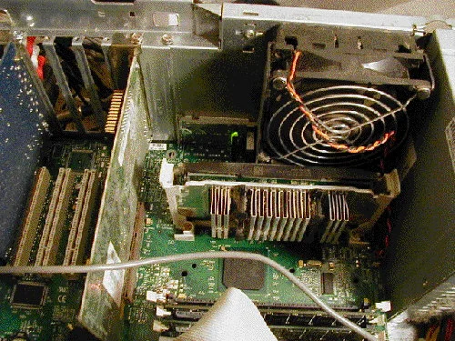

I opened up my PC, looked for a min and found myself competely lost~ Here is a pic I took, hopefully it will tell us something here.
One thing I noticed was that, the hard-drive was making this high pitch machinary noise, which is what my LCD picks up mostly. Is there a way to make it shut up, or do I just have to build a cage for this screamer?
mobo: Intel AGP set....does that mean anything??
OK, that's a slot1 CPU - with no fan on the heatsink it at all! Well, you won't get much quieter than that!
You can replace that case fan, though.
Hard drives tend to get louder as they age, and older 7200 rpm models had pretty nasty idle noise. You say your LCD monitor is picking up interference from the hard drive? That's a new one for me...are you sure its the hard drive? Do you see the interference during loud seeks, for example?

The Enermax adjustable fans are great. It's nice to be able to dial them exactly to find a good cooling/noise ratio. The fan in the pic is blowing on the heatsink, like the original 6cm fan, though I may try flipping it later to see if there's a difference. I'm using a PIII 1gHz, so the fan is not having to work too much, and there is little noise, I can't hear 'em over the hard drives.
Ahhh, ok. The label kinda threw me...since its usually on the "blowing" side. I wouldn't bother flipping it, blowing is better than sucking in this situation. ;)
Well, either you have noisy drives or some very quiet fans. ;)
