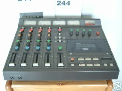

The 244's a decent deck, but...
it's not as complex in the mixer section as the 246. The 246 has independent 6-input x 4-track mixing & track assignment capability, and records up to 4 tracks simultaneously in buss mode.
The 244 is a simpler 4 input-to-stereo mixer(L/R), and records up to 2 tracks simultaneously in buss mode. There's also a function to record 4-Direct-to-4-tracks, which is good, but there's no facility to record only 3 tracks simultaneously by direct mode.
F/i, a 424mkIII is able to record in any combination of Direct-mode tracks, 1-4. On the 244, you either record 2-tracks simul in buss mode, or 4-tracks direct. There's no 3-Direct recording option. If you record 3-tracks in buss mode, you'll end up with 1 & 2, but track 3 will be identical to 1. That's just a quirk, and not necessarily a drawback.
A nice thing about the 244 is that each channel has an Access-Snd/Rcv patch point, as well as the mixer having a stereo Aux-Send buss. That's plenty of patch points for patching efx. It has nice EQ and OL LEDs, too. It has a stereo cue monitor, which you don't find on more modern Porta's. 2-Headphone jacks! (the list goes on!) For it's time, the 244 was loaded with features, which in many ways still does have better features than many later model Porta's. It was the 2nd generation Portastudio, ever. El Numero Dos.

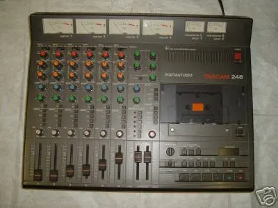

The 244's a nice, solid machine, but the 246 is noticeably more mixing and production power. For what the 244 gives as 4x2 or 4x4 (switchable) mixing/recording mode, the 246 gives a full 6x4 mixing/recording mode, full time. I know that probably doesn't make sense. :eek: On balance the between the 244 & the 246, the (3rd generation) 246 just gives you more and better features than the (2nd generation) 244.
I won't fool you,... I started on a 244 and have used it off & on this many years, and I always like to keep it handy. I know the 244 inside & out, and it's a good sounding machine with flexibility and a lot of creative potential. Sometimes you have to replace the belts & rubber parts, but they run for years & years (decades) if you take care of them. I won't lie & tell you I've never worked on my 244. I have, but I feel a deck like that is worth repairing, if necessary. Likewise, many decks I've come across have very little usage & in perfect working order, and need no repair. They're built like tanks. Need I say more.
I think the 244 is a great machine, & I have a great little 244 right here that I could show'ya. ;)

Aw, heck,... they're both great decks!
Get 'em both!........ :eek: ;)

They certainly look to be taken care of, i saw a 246 from italy on ebay that was in terrible condition, i would have bid for it and done it up but i went for the 414 on ebay. I won it on Sunday, paid straight after winning the auction but haven't recieved one email from the seller. I think she was a bit peaved at the price it went for, and mabye because i sniped it when it had 10 seconds left :D he he he. There was an absolute mint 246 going on ebay down south last week, i would have paid more than what i paid for the 414, but it was pick up only. I pleaded with the guy to ship it but he just wouldn't budge. :mad:
