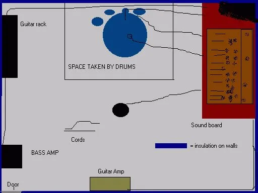

heres what its setup like now, we recorded some tonight. i made a make shift drum shield out of 5 guitar cases :) those worked damn well! haha i used one over head mike hanging from a rafter and a mic in the kick and on near the snare and hi hats! great recording! couldnt hear bass or guitars on the drum tracks! ill post recordigns as soon as i get them on the pc

Baffles can be good for sound isolation.
There are many flexible options, and there's no one right way.
Even mic positioning can isolate instruments, to a large degree.

just need some better mics for those drums!! haha this was with us al playing at once at normal playing volume.. i built the wall with 8 guitar casses and used three mics.. on in kick one near snare and hi hats and one over head..
