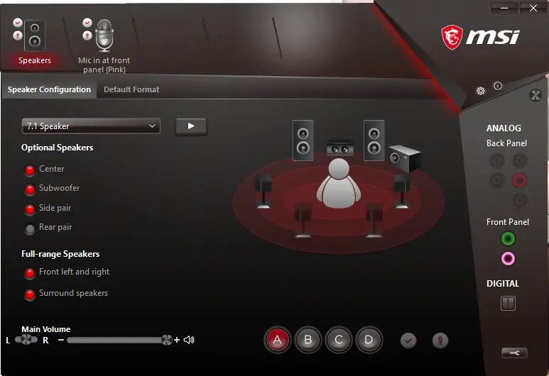

Interface: generally spoken, how to set this up?
As is:
Possible suggestions, Sir?
Wait. Are you just plugging into the computers input? You need an audio interface, usually a USB device with mic and line inputs. That will have the zero latency monitoring so you can hear what is being recorded without any delay (latency)
If you need to record through a plugin, that plugin need to be placed on an input channel. And the input channel need to be set up to monitor while recording (usually a button on that channel)
Normally when you record something, you plug a mic into the audio interface, plug the headphones into the interface and you will be able to hear what is coming into the interface separately from what is happening in the daw. That is why reaper defaults to turning off the input signal during recording. It's so you don't hear it twice. (Once from the interface and once from the daw)
A lot of the problems you are having come from not having the right tool for the job. The built in sound on a computer are fine for zoom meetings and listening to YouTube videos, but it does not have the features necessary for real audio work.

You said something about a microphone. What is that plugged into?
Farview speaks words of wisdom, so its worth heading his advice.
Using your PC's internal sound and its inputs and outputs are not going to give you much joy if you want to record more seriously than just tinkering around. An audio interface is designed specicially for recording; to allow full duplex audio, which is being able to efficently playback material while recording new material.
When you use an interface, it takes the place of your internal audio. All inputs plug into it (mikes etc), as do all outputs (headphones, speakers). It provides you with a means of direct monitoring your input when recording, while at the same time hearing what has already been recorded.
Reaper (as do other DAWS) provides you with software monitoring, which is its default setting for recording.
Software monitoring has an inherent delay (latency) because of the processing involved. Latency will depend on how fast your machine can process the audio. Latency is typically very high when using internal audio.
