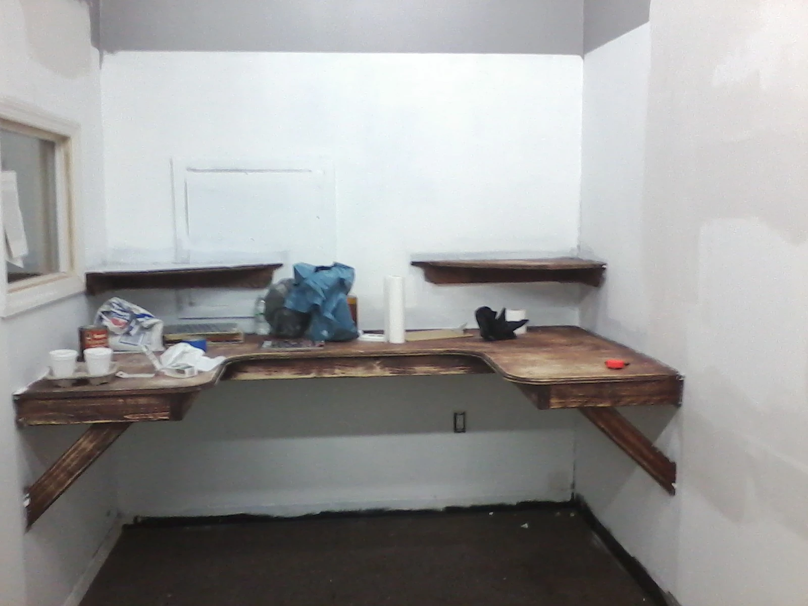

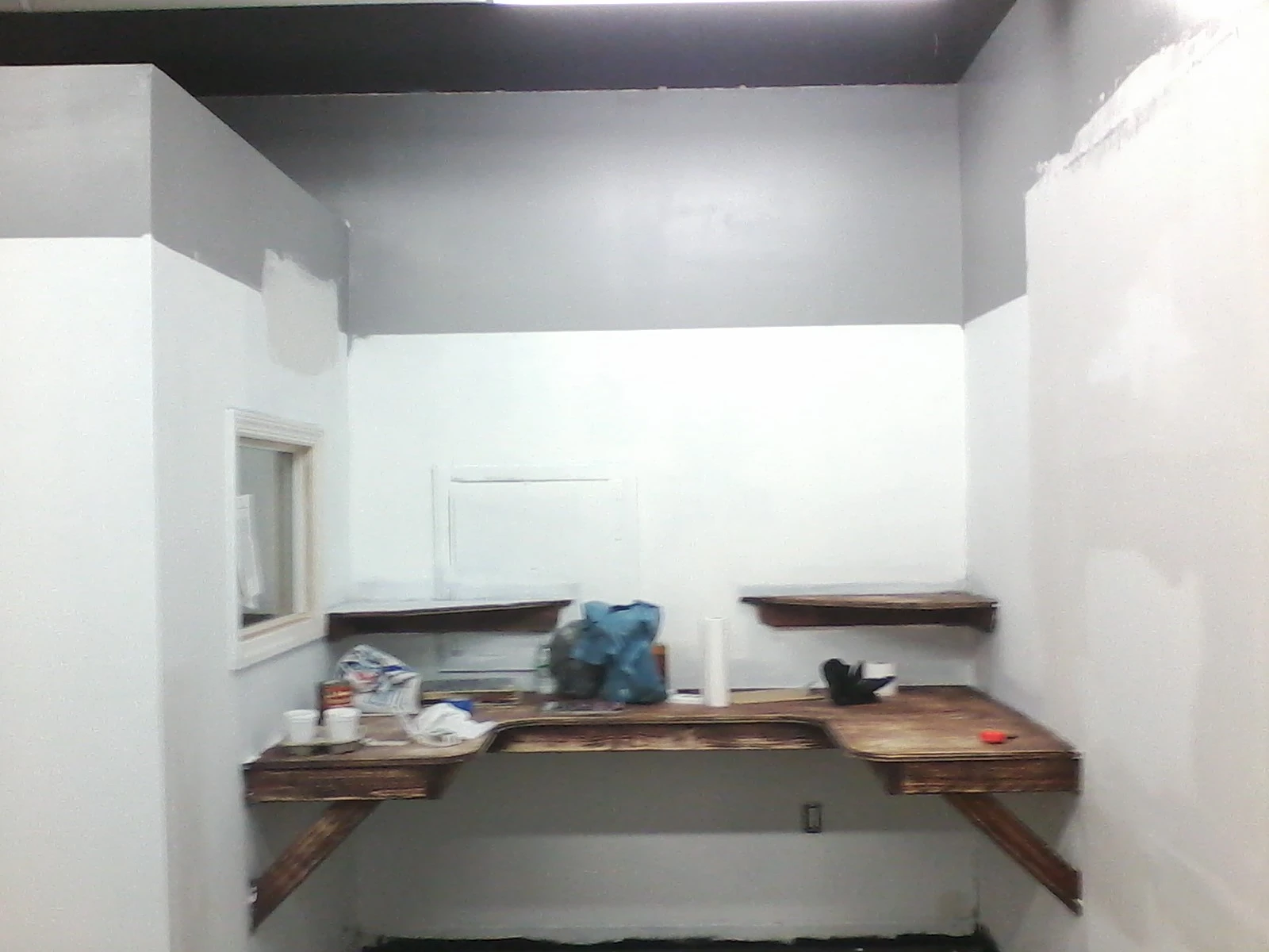

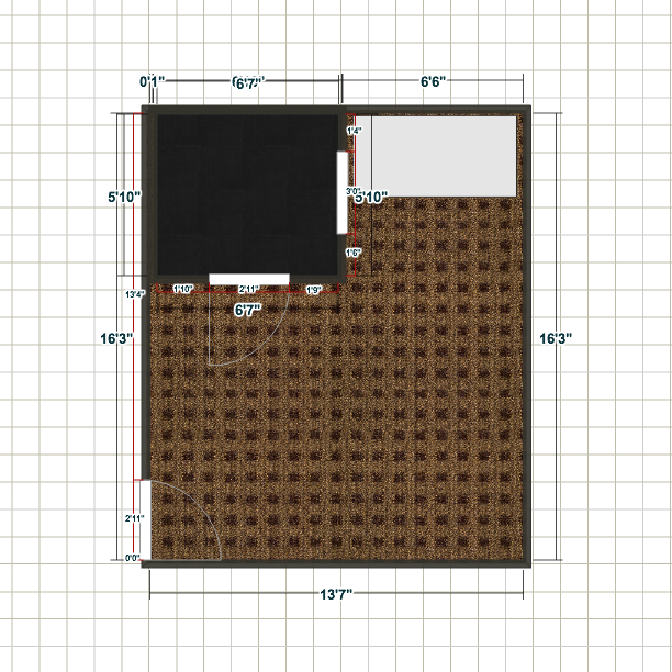

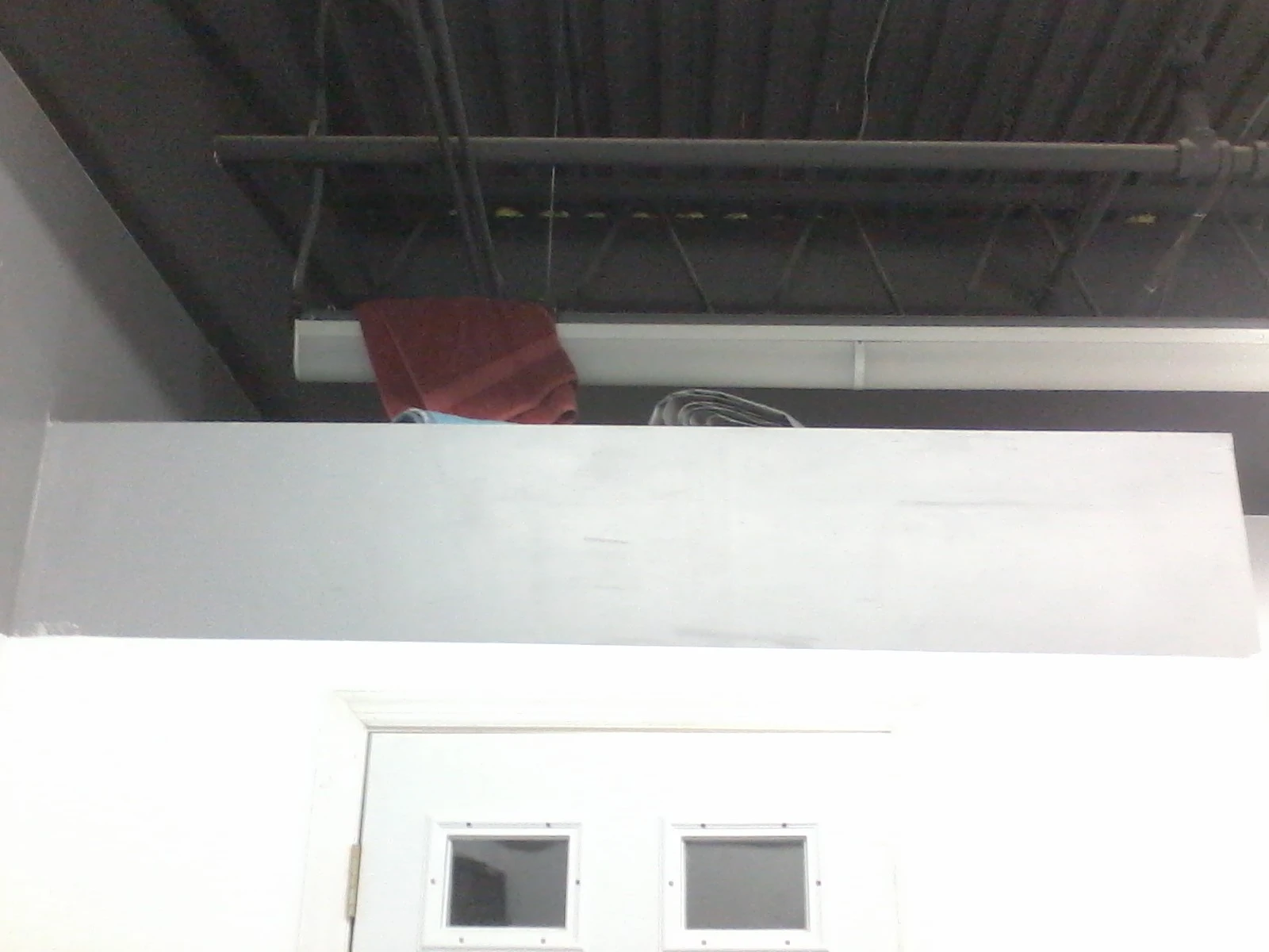

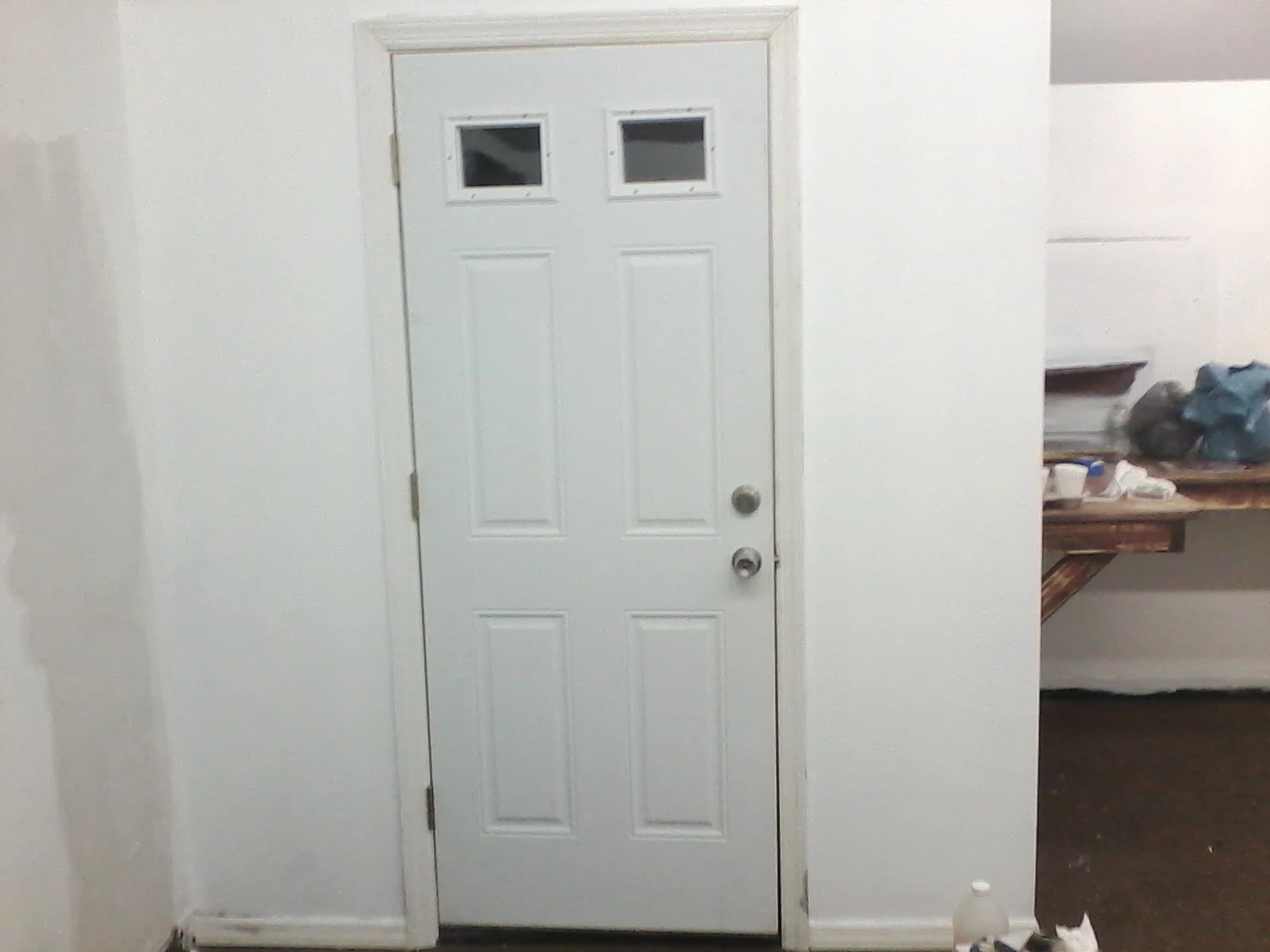

Corner desk setup next to vocal booth
I have photos attached of the room. iam renting it in a commercial place. the table came with the room and the vocal booth also. i wanna know if i should leave the mixing desk in the corner.or should i move and if i do which wall? can i leave it there if i treat the room acoustically. room layout is there also ill include the measurements
The room is 16ft 3 1/2in long 13ft 7 1/2in wide 13' 5 1/2in high. the vocal booth inside is 4ft 9 3/4in long 5ft 6 1/4in wide 7ft 11in high (the outside of the vocal booth is 5ft 10in long by 6ft 7in wide) the vocal booth has a 3ft window on the side. if drop ceiling were installed what wold be a good height?
