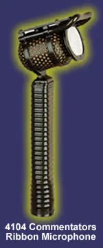

The best mic. for picking up voice with minimal background noise is THIS:-
I would not use it for singing though. :D

John: No thanks. It looks like a centipede rather than a microphone.

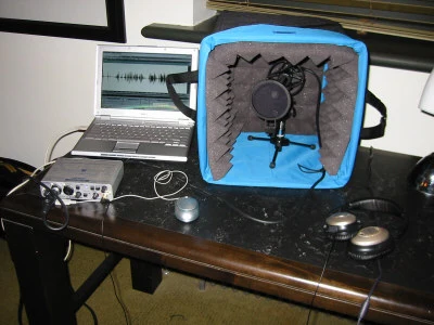

How about this microphone booth? I think it'll perform quite well in audio recording. However, there is a really BIG problem if I use this in the recording the video scenes.
