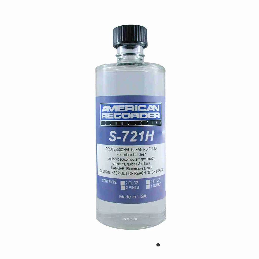

Im been using American Recorder S-721H for years on my machines with superb results, highly recommended.
Gustavo

Have you read the data sheet...?
That stuff is predominantly hexane...which will fuck up your nervous system from prolonged exposure to the vapors.
[url]American Recorder Technologies S-721H[/URL]
I would stay away from that stuff and stick with isopropyl alcohol...YMMV...
Iso alcohol straight up...cheap, readily available, very effective, relatively low health impact.
