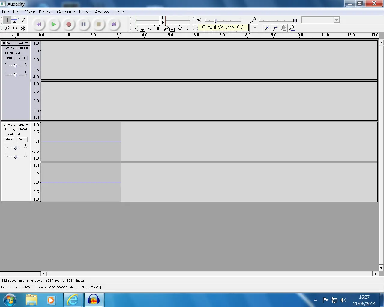

OK, cool.
You hit the solo button in your DAW and live monitor, or playback a recording, and there is no echo?
Good. That rules out the mixer then.
Stupid question....Do you have any effects enabled in your DAW?
