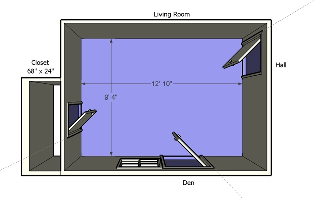

Hello everyone, I'm new to the board looking for some help. I posted this on the John Sayers board also but I want as much info as I can get.
I’m trying to build a small studio in the one empty room of our house. I need two sections in this studio, the first being where I create and mix the music. The music is all computer based (hip hop) or from samples, so I basically need a good environment to listen to the music so I can mix it properly. The second section of the studio is a place to record vocals. I currently just record in the middle of the room and they sound pretty bad with lots of annoying reverb, I’d like them to record dryer. I’m looking to start making changes to the room in the next few months, we own the property so we can do what we like but it we are also limited by the fact that people walk through this section of the house to get to back room. This room also functions as a hangout when we are making music.
I’m not worried about keeping sound in the room because we usually keep it at reasonable levels that won’t disturb the neighbors.
Current Room: The dimensions are listed in the photo. The ceiling is 8ft tall, there is currently carpet on the floor. There is one window that cannot be removed but can possibly be covered by something from the inside (don’t ask why there is a window in the middle of the house). The door next to the window is hollow, the rest of the doors are solid wood. This house was built in 1948 so there is a crawl space underneath the floor and a small attic with no insulation above the ceiling. The walls and ceiling are all drywall.

Have you looked at John Sayer's plans? You'd have to play with it some because of your doors (and that closet) but I'd say that's a darn good place to start from.
DForm said:
Questions:
What is the best layout for the room?
Where should the mixing station be and where should the vocals be recorded?
What is a good use for the closet (I always thought vocals)?
What kind of treatments need to be applied to the walls?
Where do I place the monitors?
Is carpet better than wood flooring? (The wife is placing wood in the rest of the house)
Hi, i sure there are many thoughts on this, i'll tell you mine.
I would put the mixing console in the middle of the wall..the one without a door on it, To each side put the monitor speakers at earlevel and angled in a triangle with you being the tip. I wouldnt record vocals in the middle of the room, generally its not a good idea to record in the middle of a small room because of standing waves. Depends on your room though so see what suits you. I would personally use the closet for recording "dry" vocals. I could only speculate as to what materials to use, theres better guys on here for that..im sure they will be along in a bit if they havent replied already. In the room itself i would make some bass traps and absorbers and i would probably go with a wood floor.
I too would probably go with a wood floor. I disagree on the console placement though. I'd put it out from one of the short walls. You want the speakers to run the length of the room.
I'm no expert, I just read a lot so take it with a grain of salt.
I would mix the lenght of the room (sound towards the hall) and use the closet as a vocal booth or do a Hart booth in the corner, but you'll likely want that corner as the hang out area.

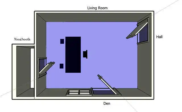

For your purposes I would not put my type of booth in your room though. It really screws up the balance of the room and that's something I'm struggling with for my mixing area now, but for me as a voiceover type the booth was more important so it took precedence.
Here, a picture is worth a thousand words right? It's not to scale, but you get the idea.

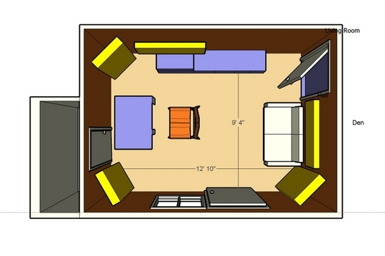

OK,
I talked to my wife about this and it looks like my desk is going to have to be close to the wall where the closet is. She's an ex interior designer which has it's pros and cons but doesn't always bode well for the home studio.
The desk can block entry to the closet because I will make one side able to fold down and the closet is only going to be for storage. The desk is only going to have an LCD monitor and 49 key keyboard on top. The mouse and typing keyboard are going to be in a slide out drawer which will actually push my head about 50 inches from the wall. Looking on the web I found the rull of 38% which for me will be impossible but 38% from the wall is about 58 inches so I'm not too far off.
Another questions my wife made me think of: Would making the closet door out of plexiglass be too reflective if it is behind the speakers?
Here is a sample of the room updated a little bit. The yellow are absorbers, the long blue thing against the wall is seating that doubles with storage for my records and also holds my turntable and mixer on the left end. I would put a moveable bass trap in the corner by the door when the room is in use unless there is a better solution.

Cool. I see you've been studying.
Read up on first reflection points. I see you've got treatment on the right side of the room but not the left. That's going to cause some issues. You might consider building a "plug" and putting it in the window so you can even out the balance.
For a movable bass trap. Hmm. I seem to recall a few discussions about building gobos on casters that would work for this I think.
You could consider putting your desk on casters too so you could move it a bit to make getting in and out of the closet easier. Careful placement of your cabling should make this pretty easy.
I hope some others chime in soon because you've now just about reached the limit of my knowledge and I don't want to be one of the people who gives out bad information, no matter how well meaning it is. :D
Keep up the good work.
For the first reflection point next to the window if you don't want to lose the window try adding some heavy drapes that you can close while listening and recording.
That window is killing me. Both me and my wife hate it for different reasons. We would just remove it if we could but code won't allow us to.
The drapes sound like a good idea or we might just place a sheet of plywood in it and make it flush with the wall on both sides. Then I can put the absorber on top of it. If we put drapes on one side and an absorber on the other would that have a negative effect?
Putting the desk on casters is a good idea too.
