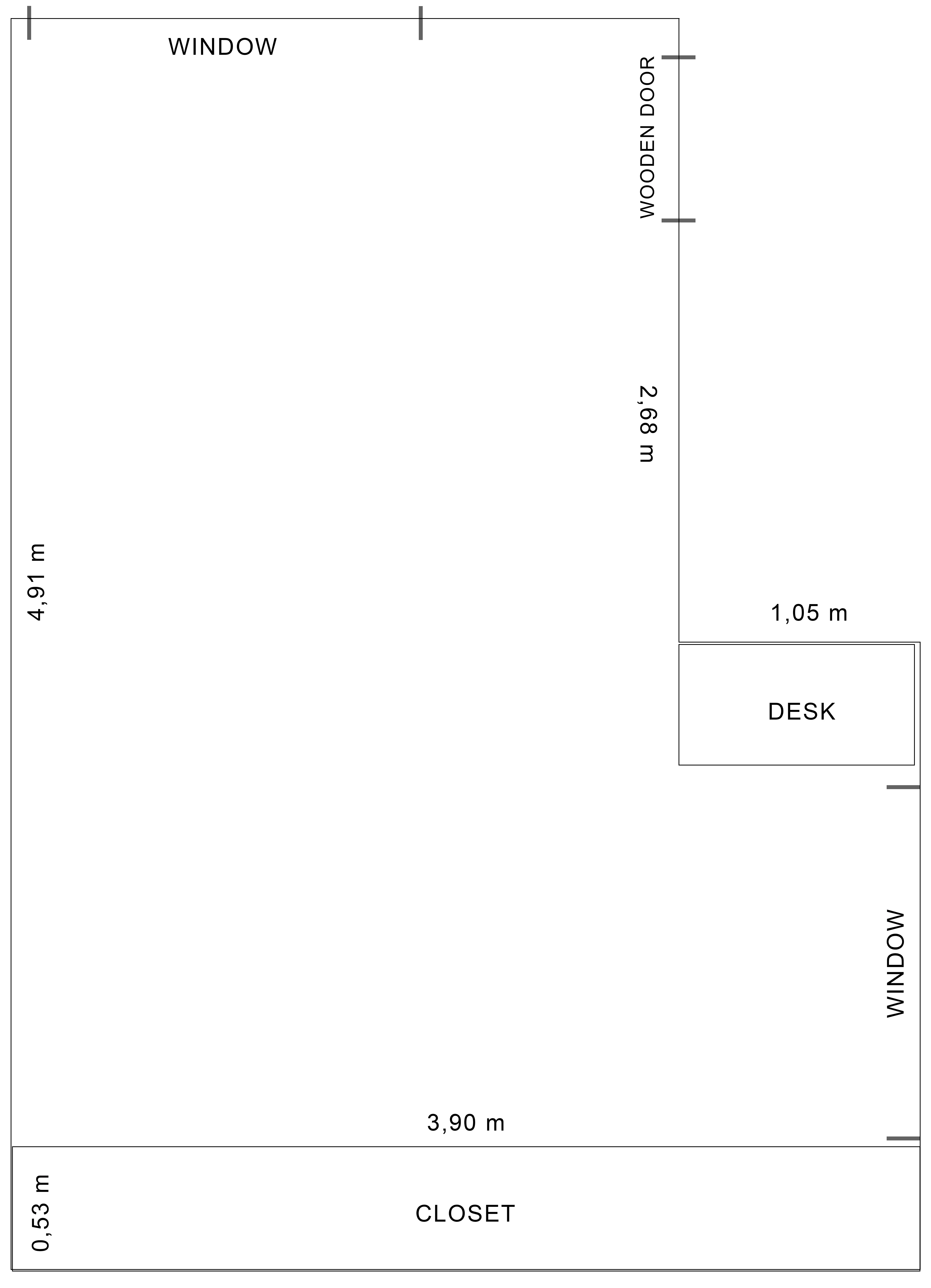

Hi! I'm planning on building a small studio in my small bedroom, which has an irregular shape. Here I post an image with its shape and dimensions so any of you can suggest ideas on where is the best place for mixing and placing acoustic treatment:

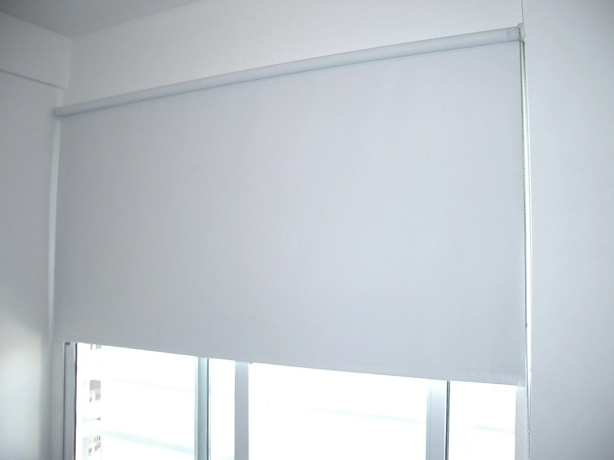

My current desk position is as shown, which is a terrible place for mixing. My first idea is to place it against the closet so the monitors are placed in the middle of the two long walls, facing the window next to the door. The problem I find is the cavity where my desk is right now, which can affect the speaker reflections, and since I can't treat the windows, that would be a serious problem. Both windows have this kind of curtain:

Hi Franco and welcome to ze madhouse!
First up, I am NO acoustician/studio builder, just an old valve tech that has picked up a few things. You are right, setup affront the closet but the hard doors are going to mess with things and since I doubt you will be able to stick stuff to the doors(?) you need, IMHO to be thinking about "gobos". These are panels that are used to block spill but if make say 200mm thick could be filled with rockwool with a "fret" on the front/back. These would go behind the monitors which could themselves be 1.5mtrs or so from the closet. Another similar panel goes to your left flank and should help stop reflections from the window.
Bass traps: You could put a LOT where the desk is at present! Does the closet go to the ceiling (and how high is that?)? If not, whack some trapping on there. Even if the closet does go to the ceiling I bet there is a void above the storage space? Fill that. You say the closet has "stuff" in it? If things like spare blankets, duvet, sheets in bags, these things are doing sterling service as LF absorbers. Windows generally have 1/2mtr or so above them.
You seem to be limited in what you can (allowed to?) do so maybe come back with a list of those limits? That is not a TINY room and the odd shape helps to break up the "modes". I think it can be made very useful.
Thanks for the reply! I forgot to mention the room height and some other details. It's 2,73 mts high, but the closet does not go to the ceiling, leaving a 40cm space, which is currently filled with suitcases and cardboard boxes. I can place treatment on the closet doors, so that wouldn't be a problem. Other idea that I thought about was placing like a wooden panel in the cavity so that walls are parallel, but I don't know if that would work. My limitations are most of the corners where I can't place bass traps (only in my current desk position and in the space between the closet and the ceiling) and the windows, which can't be covered with treatment, so maybe I can place those gobos to catch reflections going to the windows and remove them later. I'm afraid of windows reflections hahaha
Not sure what you mean about "panels in the cavity"? If you have redundant spaces, fill 'em with rock wool or Glass Fibre. You can leave the stuff in its plastic bag. Same goes for the top of the closet, put bags of RW or GF where you can.
I think you misunderstood me about the gobos? The problem with a nearby hard surface, closet doors, window on left, is that it messes with the stereo imaging. Ideally you want each side of the listening position to be identical. A gobo will A, absorb some of the sound going TO the window and, usefully, much of the (weaker) reflection coming back. This effect, plus the benefits of "near field monitoring" should ensure a pretty good image. The gobos will only absorb at higher mid and high frequencies but these are the important ones for stereo imaging.
