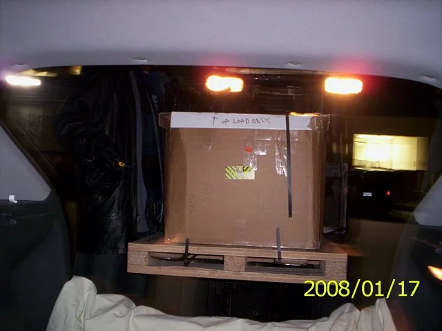

I'd just add, that although crating the recorder, with some internal padding inside and strapping it to a pallet is the ultimate way to ship, it can be very costly. That is why I advise boxing it very well, with a shit load of styrofoam all around (all sides acting like additional walls) and strapping that box to a pallet (which is a bit larger than the box). It doesn't cost much, maybe about twice what the normal, typical and cheapest ground service is like. The benefit is that it's much safer and the recorder will not be dropped and tossed around by hired hand.
In fact, here's a Tascam 48 delivered on a pallet and ME cutting the straps (note knife in hand) and placing the box inside of my Hyundai Accent. (Note the forklift holding it for me). The weight of the thing (box + pallet) was 180lbs.

there are a few good semi psychological tips which can be used at hardly any cost. noting "do not top load " will help. Labeling "fragile glass" will make a difference. "tip N Tells" are stickers with a plastic triangle filled with sand which shows if the cartons are tipped. from my experience, they do help quite a bit. a guy flying around on a towmotor will notice them as they are eye catchers. subliminal caution.
doing something visually to make the carton stand out helps.the only downside of banding it to a pallet, is as it is usually handled by forklift theres a blade pierce chance as well as a good chance of freight being stacked on top as it will usually be loaded on the bed of the truck.
but i would still go with banding it to a pallet. its a crap shoot any way you look at it, but you may as well do your best to swing the odds in your favor.

I agree with you and if I had to go from the absolute worst to best, I'd do this:
WORST (chance of mishandling / damage HIGH): "Typical" shipping methods via USPS or couriers UPS, Fedex, DHL, non palletized
MUCH BETTER (chance of mishandling / damage MODERATE - LOW): box strapped to a pallet, shipped freight*
*to make a mishap truly low or non-existent, line the box with some 1/4" wood, all around (and top), in addition to the thick styrofoam.
BEST (absolutely lowest chance of damage): Well packed / padded box placed inside of a crate - 4 walls of wood surround box**
**this is the most expensive
absolute best: Drive to seller's house and load it in your vehicle. ;)
