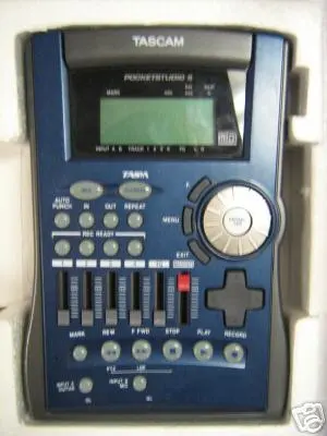

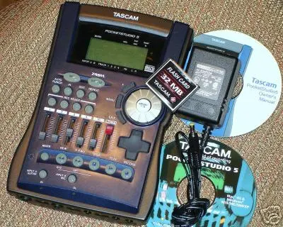

Seriously? Get the Tascam Pocketstudio 5 !!! It Rocks !!!
... & does e'thing you need!
Aaaggghhh!!! Wrong forum again!!!
Anyway, for what you specify, I'd seriously get the PS5.
Wait,... I already have one!:eek:;)
Monstrosity? No, it's a cute, diminutive, friendly & unthreatening little thing!
The Pocketstudio 5 records multitrack (up to 2-simul/4-total) in a 64 kbps modified mp3 format, along with other proprietary format files to keep track of the system settings and arrangements, onto CF flash memory cards. It renders 128kbps stereo mp3's from the multitrack files internally, as well as outputting a line level stereo audio signal & headphone output. It records directly in stereo onto 128kbps mp3 format files, as an alternative to multitracking. It also plays SMF files for MIDI arrangements from it's internal MIDI tone generator. It can load and play "commercially" available 128 kbps files as an mp3 player. It has an internal condenser mic, as well as a mic & line in, plus internal effects & USB file transfer. As an aside, it has faders, 1/4" inputs, and is battery or AC adapter powered. (Hint: this thing is perfect for 'field recording').
The bottom line? I think it's incredibly versatile for such a small package & sounds pretty good, despite what you may assume about the format and specs! Good enough to create wav format files from it's line out or to dub to tape, as well as rendering mp3's internally, and has sound quality that would stand it's ground against your faithful 4-track cassette.
You heard it here first!
PS: It's handy and pocket sized!:eek:;)
Aaaggghhh!!! Wrong forum again!!!:eek:;)
That it seems to only ever store the master tracks in lossy MP3 format was enough for me. Perhaps 'monstrosity' was too kind :D
Now if it could record in lossless format, that would make it a useful little gadget...
... uhuh,... uhuh,...
My friend, in digital there's no such thing as a "lossless" format. You, of all people, should know this point will be endlessly debated in analog/audiophile circles. Even your "standard" CD quality has a data & frequency cutoff point, as well as the ever hailed 24-bit/96k.
Do we really want to go down this road again?
For the question, what I've suggested are good tools, and I'll stand by that!:eek:;)

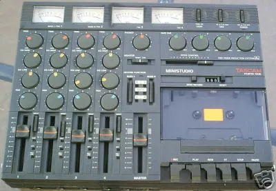

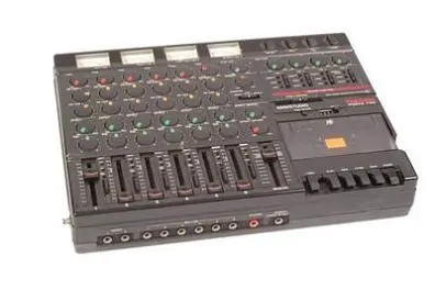

If I really, really wanted to have field recording portability in analog with some good sound & versatility, I'd get a Porta One or Porta Two. Forget the rest and call it a day!
Wait,... I already have those!:eek:;)
The strap buttons are really the icing on the cake!
... of a true field recorder!:eek:;)
