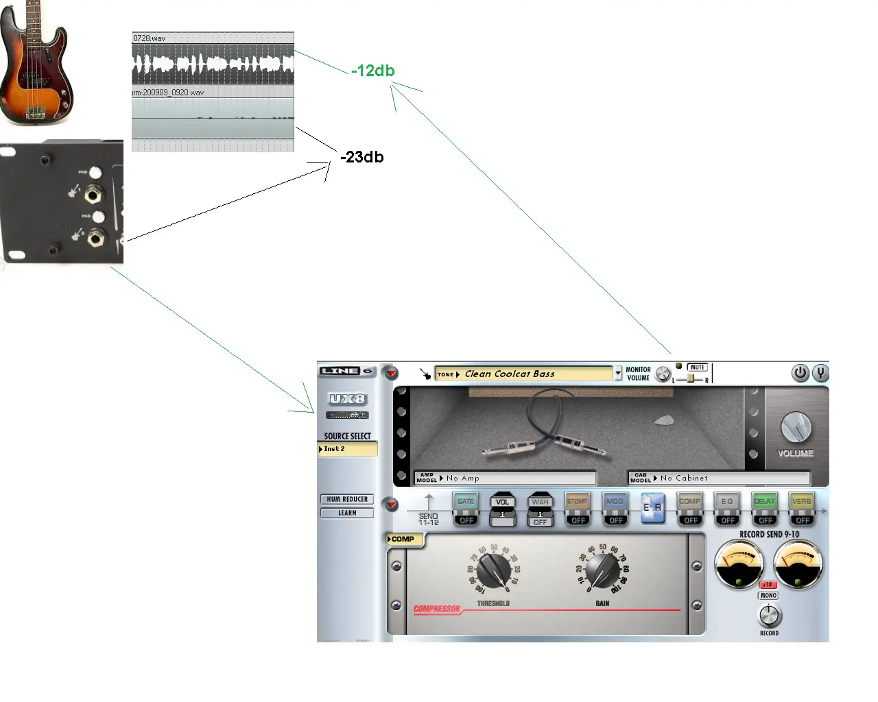

I looked in the manual and my INST input has 1 Meg Impedance.
It has no knobs for gain and has a -20db pad. (I dont see any spec on how much gain there is if any.)
The L6 UX8 Manual states this unit is designed to run "directly with GearBox/PodFarm" running.
Apparently they didnt think about users, like myself, too lazy to click a mouse a couple times..:D
I actually learned something new through this discussion!
the DAW wave form, with the software running as is designed for this unit, is much more normal to my outboard gear. Without the software setup it was -23 signal :wtf:, with the software ON and no fx/ no plugins I could easily get over -12 to -6. a nice fat large wave form...:guitar:
subjective preferences...
still recording Line In with some outboard is fun, and maybe more placebo than I think, as the direct to interface INST + software realtime plugins ... can get just as good a track.. (with a ocean of more options).
so I guess I can confirm, some of the lesser-desired sounds was due to the ...errrrr.....User

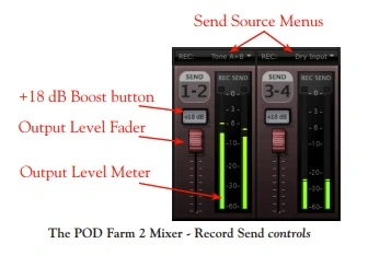

Looking through a manual (Pod Farm 2 Advanced User Guide?), there is an audio Mixer which offers control for input gain to DAW.
See Section 6 Pages 8-11. Not sure if this covers your setup.

Most simplest Bass - If I plug my US P-Bass into the Interface Instrument jack, there is hardly any signal = no wave.
I can hear it if I turn my headphone way up. Can add volume later I suppose. There seems a odd digital compression/limiter too on my unit....

I just need to use the Interface DI with the Gearbox/Podfarm as designed, no problem.
It does have the +18 too. A bunch of digital gain in all the plugins and sims. (User error on my behalf)
"when in doubt read the manual!" :D

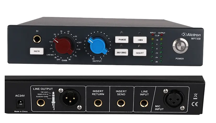

1) Radial JDI > > Mic Pre INterface or Radial JDI > outboard preamp> Interface Line In is another approach.
2)the recent unit Alcrtron73mp (great river clone) is pretty good but seems gritty, sharper,...not smooth and round...but oddly if I put on the PHASE it sounds smoother and rounder? :wtf:
theres an ocean of great gear outboard, hardware.
yeah..I could sell all the hardware for $1000 and just use ITB- realtime Amp sims etc...but I tried that before and prefer having at least 1qty channel of Hardware for the non-mouse needed approach, its not about cost but more vibe preference.
